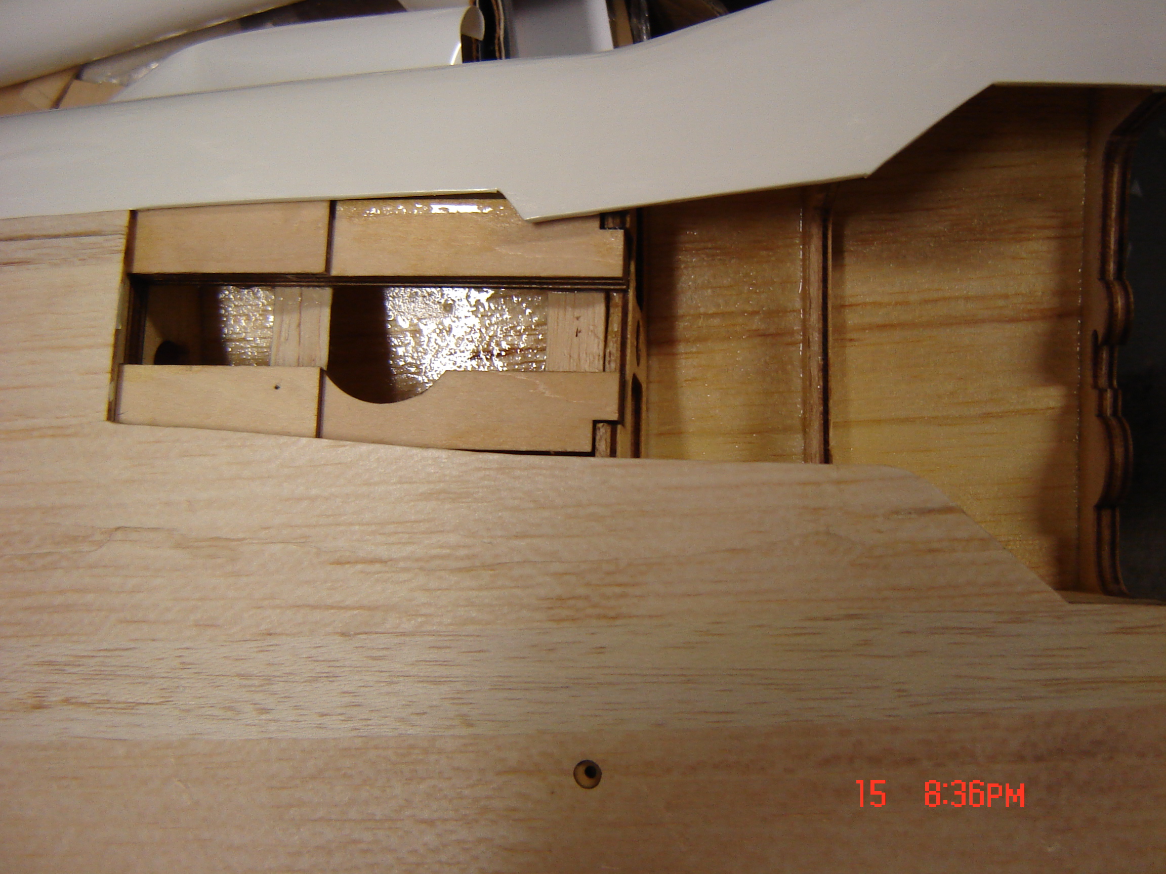

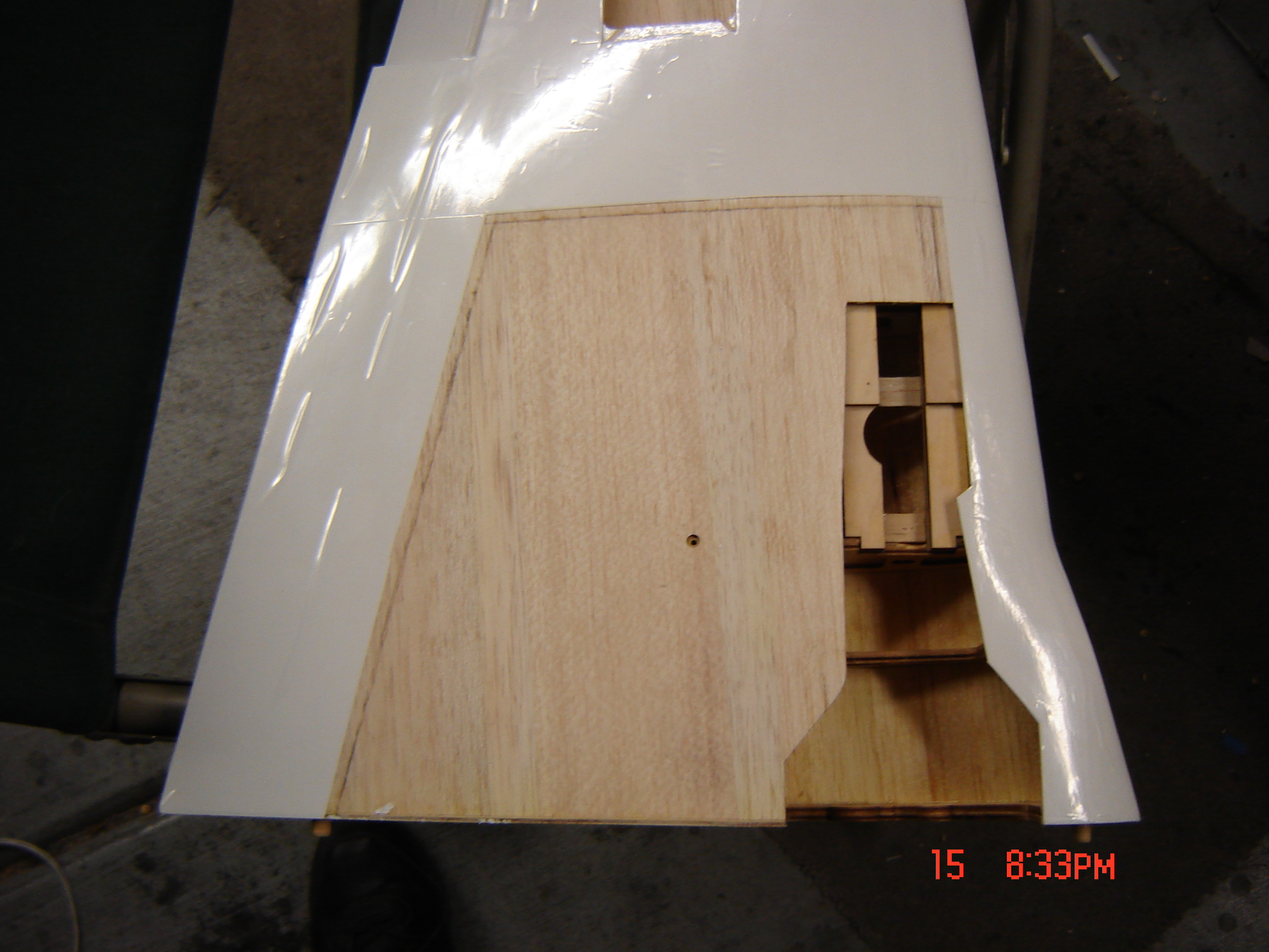

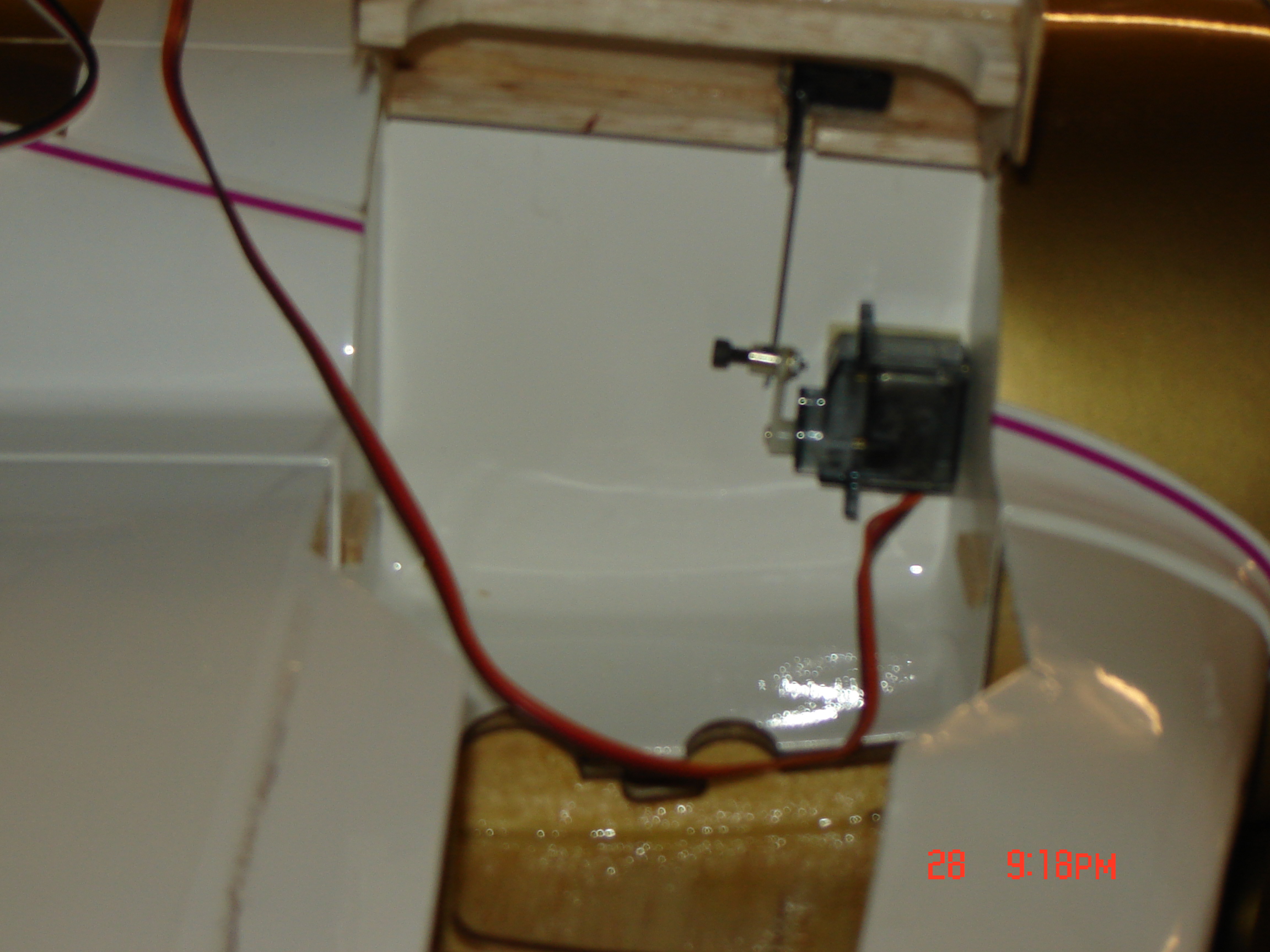

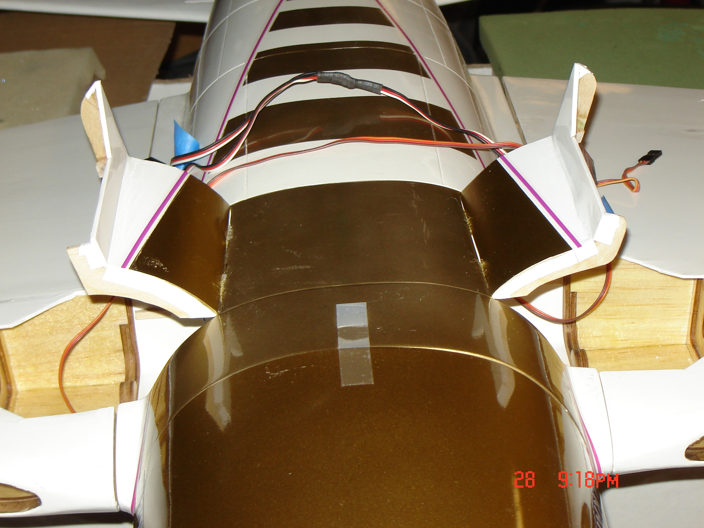

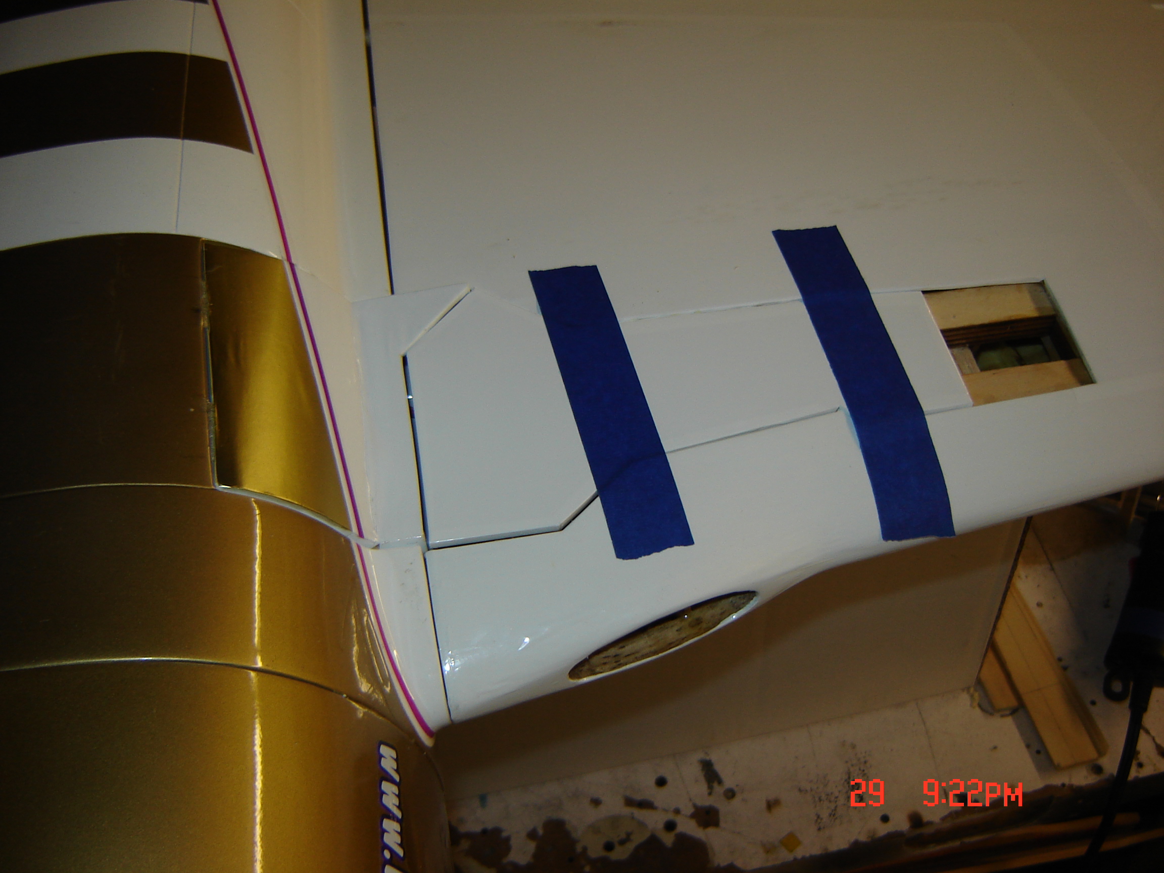

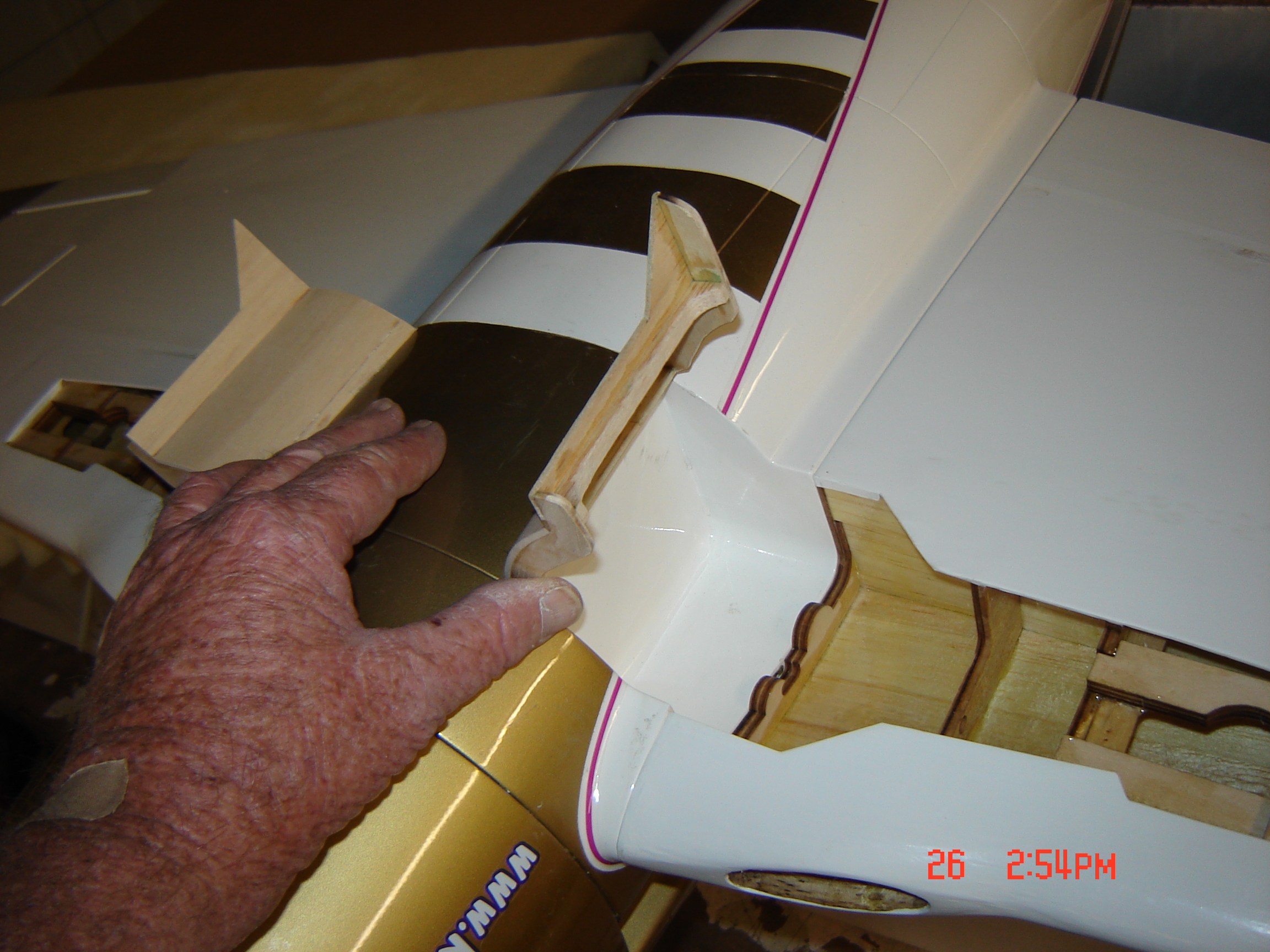

The inner gear doors are complete, (see photos). I used light ply to trace the contour of the front and back of the openings and 1/4"x1/2" balsa to join them and sheeted with 1/8th" balsa. Surface mounted mini servos with the servo horns glued to the inside of the door with a adjustable connector on the servo output arm. The doors are covered with white monokote and the trim color is model masters brass paint for air brush application. The color match is not exact but close and it's on the bottom so I hope I don't get to many complaints about the match.I installed and set up the door sequencer w/3sec. delay to be sure the gear will not interfer with them. they are mounted to the fuse with Great Planes fabric hinges and CA glued. If anyone has any suggestions or comments I would be greatful.

Beautiful work. I have to admit to not thinking there would be enough room for a servo in the well itself. Solves so many problems.It might take a bit more work now, but another option for me would be to mount the servos against the rear face with the shaft only protruding through the wall.
How stiff is the structure with balsa sheeting alone? Also could not spot how you hinged the doors.
Any issues programming that sequencer?

The servos are better fit to install in the back and front well wall particularly if you do not have a servo reverser or match box. One door will open and the other will close without it. I chose to mount them in opposite positions to eliminate the match box for now. If they work I will be installing them in a perminate position thru the back wall of the well with a match box.The location for now is temporary.The balsa sheeting on the inner gear doors are strong and addaquite for there proposed purpose. They will be closed during any high speed flying and only opened during landing approaches at lower speeds. The hinges are at the very top of the well and bottom of the fuse, I used Great Planes CA hinges. The sequencer was set up using a mock up door for testing until my light bulb came on and I was successful programing them,( trial and error ) I also chose to make new gear doors to replace the supplied plastic ones. (See photos.) What size wheel did you use and mfg. name?

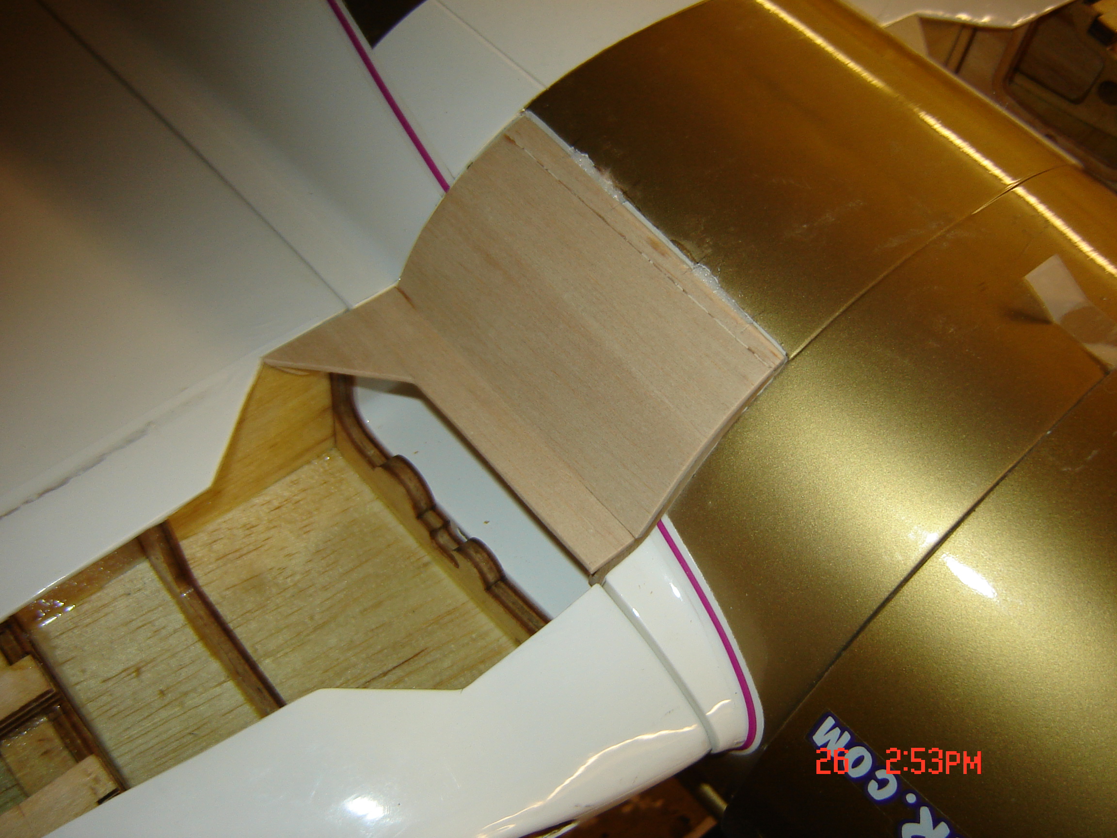

Once I had the bugs out the plan was also to chuck those thin plastic gear doors. Since I redid the wells they would not fit anyway. My method to pattern this type of assembly was to tape a relatively thick and clear plastic sheet, (such as that used to cover document folders) and mark each intersection. I then transfer those intersections to what will be the door material. With straight lines joining them together this is relatively easy.
As for the door material I was going to use my standard method for making stiff structures. Two thinner sheets of ply can be layered with one or more bids of glass cloth. Flat bits are simple as the entire setup is weighted down between two sheets of 1/4" plexi. Once cured it is VERY stiff and can be cut to shape on the saw. I can tailor the number of bids and layers of ply to get any thickness and strength required. Often make wing joiners, firewalls and braces this way and can state with confidence the final product is nearly indestructible.
Contoured is a bit more difficult, using a method similar to what you had to form the inner doors. With this method you would use only the first thin sheet as the inner layer to hold the correct shape. Once removed it may be necessary to hold it in a fixture to prevent warping. I would then do the bid and sheet layering to build up the assembly.The fun is to limit the amount of epoxy while still getting a good bond by controlling the location and amount of weight used. This is where sand or shot bags are really great. Plastic sheeting is again placed over the top layer and then more thin ply to help weigh it down uniformly before the bags are placed on.
In many cases thinning with methanol just a bit helps penetrate the ply sheets. It does slow down the cure time, but that's often not important.
Once cured you can cut and sand the outline to fit.

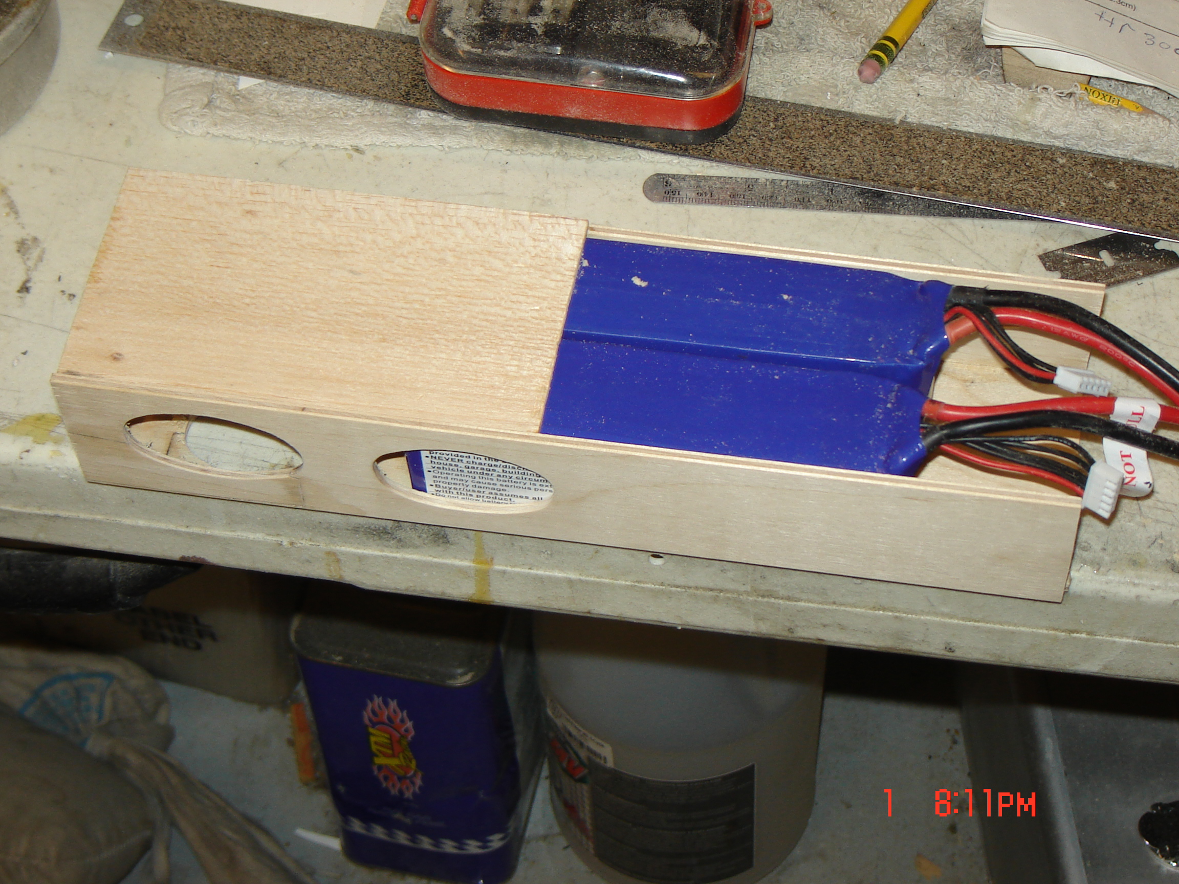

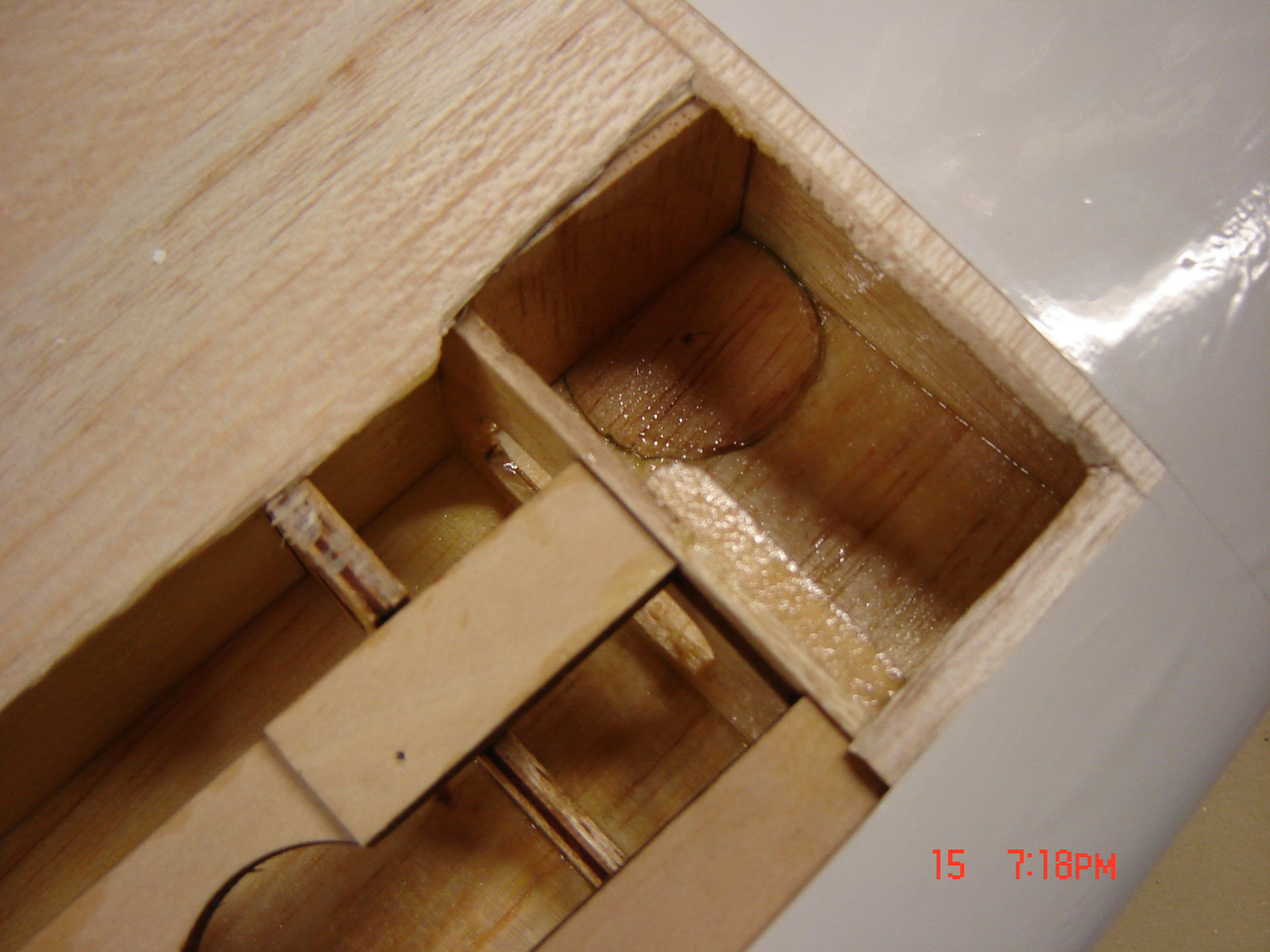

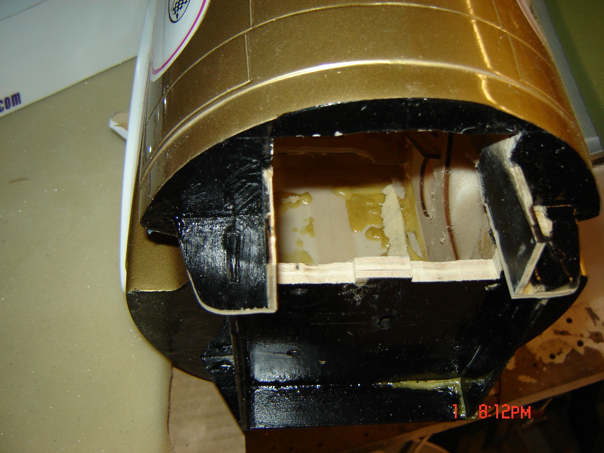

I have started working on the battery box and it's installation thru the fire wall into the fuse. I first built the box to enclose (2) four cell lipo's. The box will extend about 4" past the fire wall and 7" into the fuse in order to make it easy to install the batteries. I had to modify the fire wall to fit the box. The extenson of the box @ 4" past the FW is to aid in balancing the plane. I use 4000mah, and 2600mah batteries so one set is shorter than the other but the outside dimensions are the same. I will hold the battery in place with a removable cleat (one for each size battery) held in place with a dowel glued in place and a rc car body clip. The fitting into the fire wall penetration went very well and the box appears to work well. (See photos)

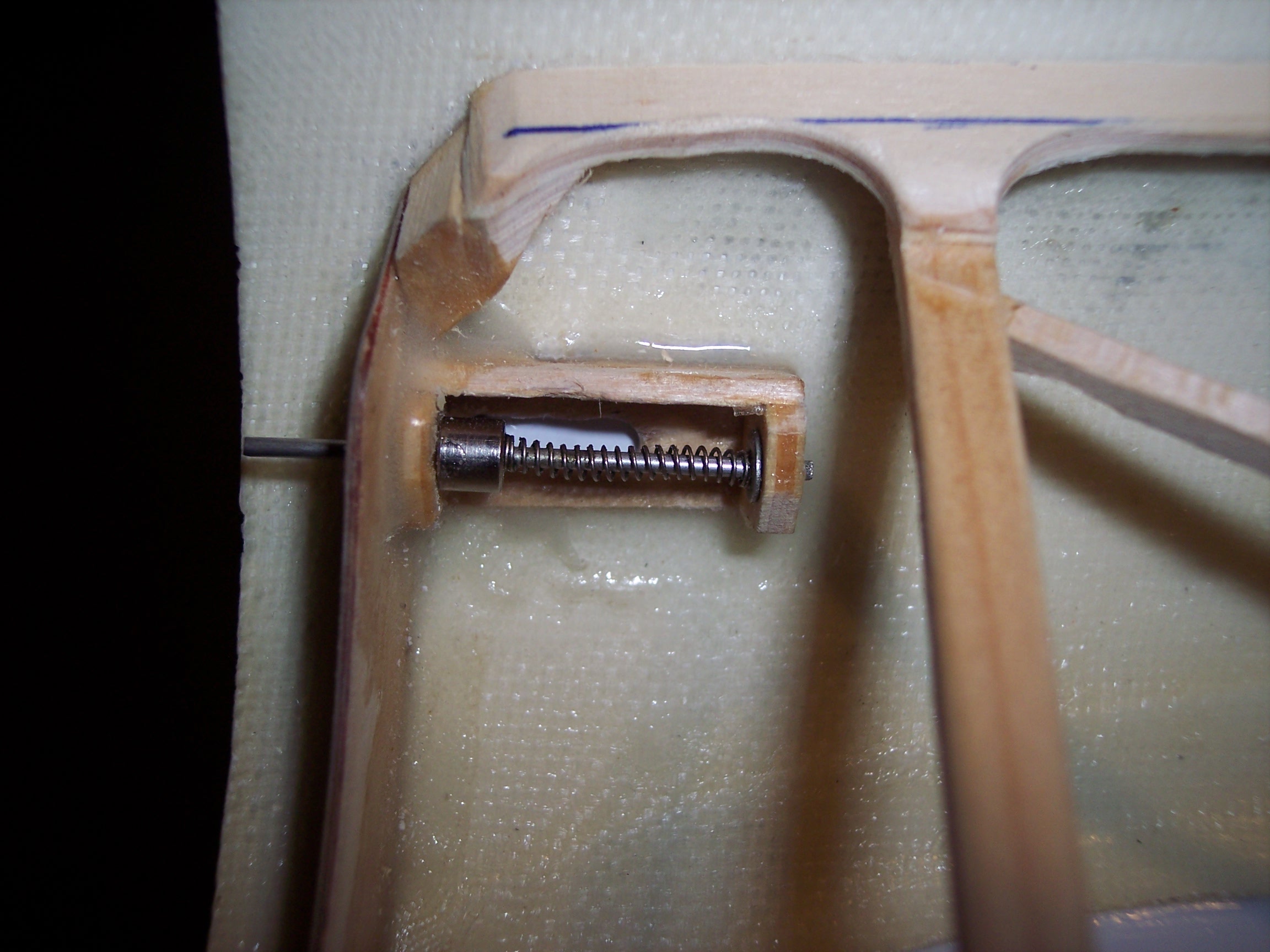

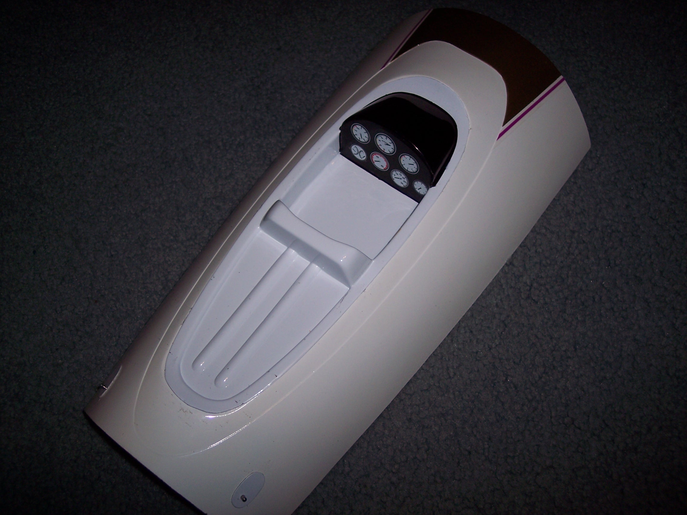

Could anyone help me with ideas on how to connect the canopy to the fuse so it can be easily removed. I was thinking counter sunk magnets in the fuse. However, someone must have a good system that does not involve ruining the exterior finish and I'd durable and easy to remove

If you go back a bit I covered my mod for a quick release canopy setup. This was required since all the switches, wing retainer system and remote glow were internal to keep the model clean.
Anyway, here it is again:
Not one to like screws marring what would otherwise be a beautiful finish, thought the difficulty of accessing the systems and checking status was abysmal with the stock setup.
Therefore, I copied what my friends use for their much higher performance turbine jets by building a frame the canopy could be bonded to. This proved a bit of fun as I was working through the cockpit opening for some of it.
The first step was to make a pattern to follow for the side, front and back pieces and for that used hard paper found at the back of writing pads. The sides came first as everything would be oriented from that base formed from a single sheet of lite ply sandwich.. It took quite a few fits and removals to get the sides relatively tight to the canopy to minimize the amount of heavy bond agent required. This was true throughout the fabrication as many checks and fits were done to ensure both a tight fit and no undue stress on what was a relatively fragile skin.
The second bit of fun comes from the fact the front and back have an intersection at multiple angles and are radiused to the sides so some form of build up was required.
Once the frame starts to take shape the work actually becomes a bit easier as you can drop it on to the fuse with the canopy removed to set up the attachment points and method. To that end I drilled three holes from what was still a gaping hole at the firewall on an upward angle through the forward flange and frame. Through this would be 3 C/F rods anchored into the frame so that when it was in place there was a slight amount of force holding the frame tight to the fuse. This eliminates aerodynamic flutter and wear that could rip the canopy off in flight, yet proves remarkably strong.
NOTE: Behind both the front and rear flanges I added either a full semi circular frame, or just extra ply doublers where the pins and retainers penetrated the fuse. That skin is too thin and weak to stand up for this use long-term.
For the quick release, I fabbed the frames from small pieces of lite ply, set up so that my wire pins would slide forward against spring pressure to release the canopy. Against the wood are small washers to keep the springs from wearing in and on the pins are small wheel retainers. To be able to work them externally, I cut down those pesky thumb retainers used to hold RS232 cables to the back of your PC. They fit into the metric collars and hold the wire tight, as well and are the only pieces external.
Bonding on the cockpit and windshield are then pretty conventional. Just ensure you roughen the skin as the amount of lift generated can be surprising.
As with anything, preparation is key. The longer spent on proper fit the better it will work and look. The final proof here was the plane did a gainer into the beans inverted, with the full impact on the canopy and top of the vertical stab. Both survived and the only damage was a mark on the pilots helmet.

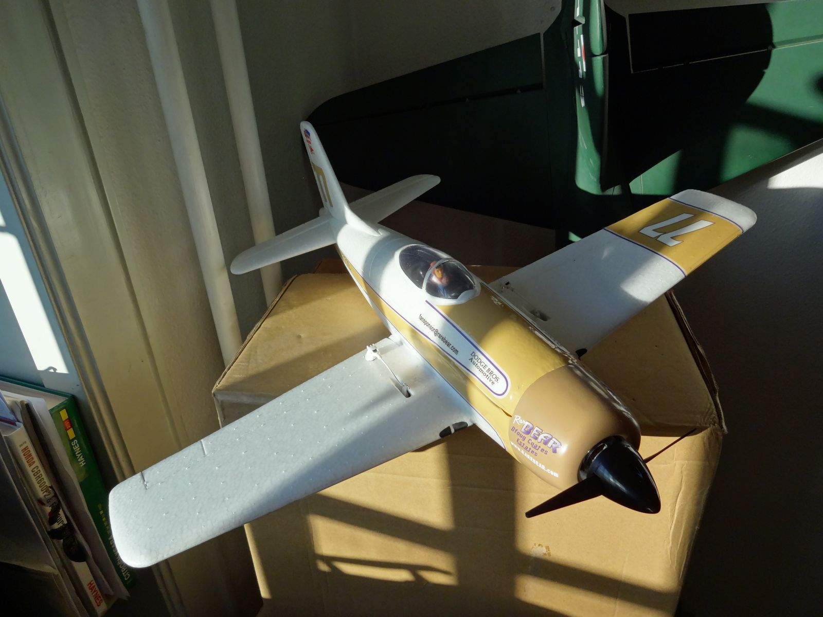

Last week I bought the little 620mm Rare Bear hrom hobbyking with a 4s 1000 battery........wow, is that a cool plane to fly.......blistering fast, but can also fly at a normal speed and make realy nice slow rolls.
