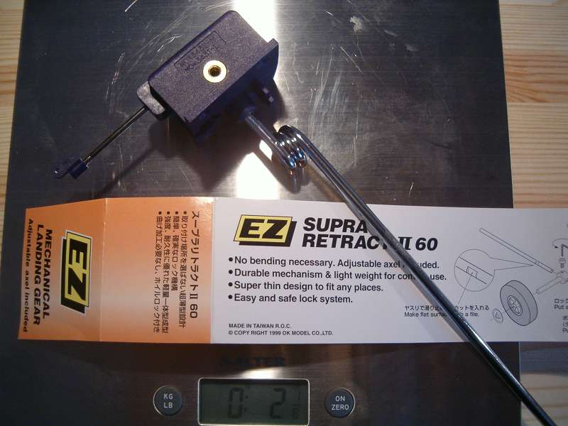

Well, I got into my Rare Bear box last night and discovered that the mechanical retracts I had were not going to work on this plane. Soooo, I went researching back through the thread and broke down and ordered a set of Robarts (550's) with a set of 663 Robostruts to go with. Then I said "Why not?" and ordered a scale retractable tail wheel as well. I ordered the whole kit with installation kit and restrictor valves, quick disconnects and 3.5" Sullivan wheels with the3 aluminum hubs. These are the phnumatic retracts and that is going to be a new experience for me as I have never done retracts before, let alone gas powered ones.
Did I do good?
Did I do good?

You know what? I have no idea! The consensus seemed to be that if you were going to use Robart struts, the 550 series were the way to go and the set I ordered are designed for the 7/16" Robostruts so I ordered those too. It just kinda snoballed from there. Since I am using an OS 1.60 for power I'm sure it will fly well but the wing loading may be kinda high. Kike I said I am new to the whole retract idea so I am kinda clueless when it comes to the details.

Nice looking quallity gear though...
...that stuff is so expensive in this county though ....and not that readilly available..[
]....i've managed to get some O.K Supra mechanicals though so all is not lost...

Lord Lucan. they aren't exactly cheap in this country either. With the wheels and all I will have about $300.00 invested in them by the time they are on the plane. The mechanicals I have are made by B&D indrustries and they actuate from the wrong side. I guess they are designed for wheels that fold up away from the fuse, not in towards it. I had said I wouldn't invest that much money in this plane but after looking it over real well........... like I said I got carried away I guess.
The ones you have look good, they should serve you well. I would caution you to make sure the wires are good and stiff though if you fly off of a grass runway. One of the gents who flies at my club has a Hanger 9 P-51 and it winds up on its nose as often as not during landings because of the spindly gear wires (and his classy landings!).
