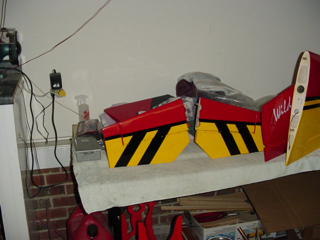

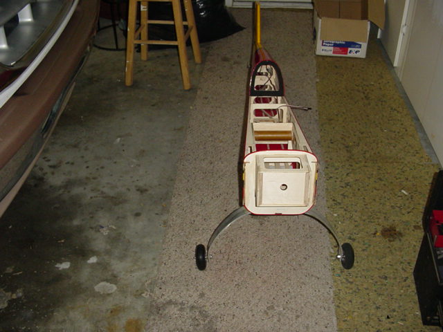

Ailerons, and Elevators 1/2's are hinged and waiting on the other 1/2 to dry.

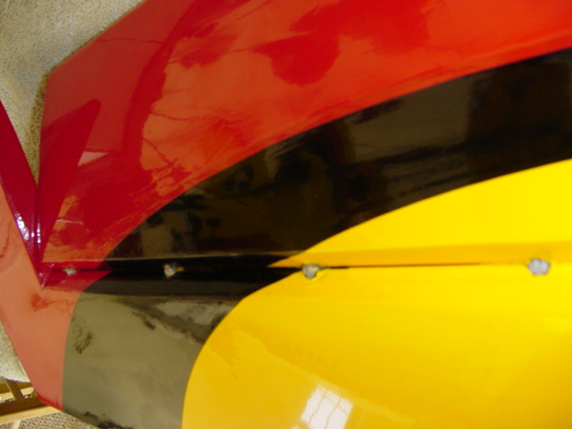

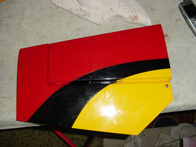

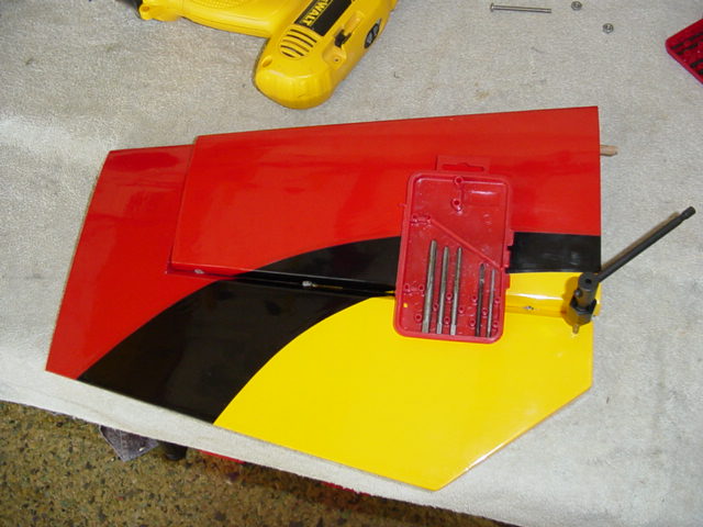

Ok working around the cowl issue this is what i accomplished tonight
Drilled and taped elevator 1/2, and the ailerons for the 8-32 hardware.
ID:	124179   Click image for larger version
ID:	124180   Click image for larger version

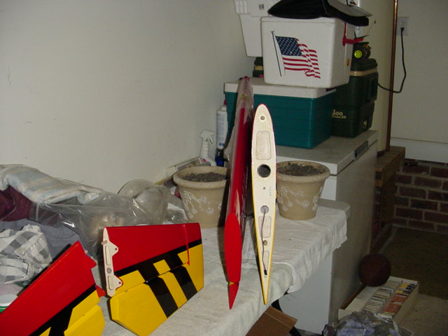

great i have the cub yellow, true red, and black to go to work on those surfaces for sealing

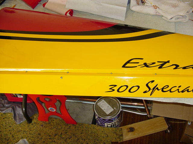

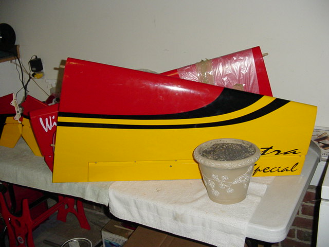

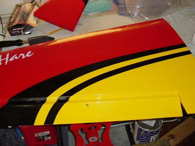

lets move onto the wings the right wing will be quite easy to seal as it only will require cub yellow, now that left wing makes me work some

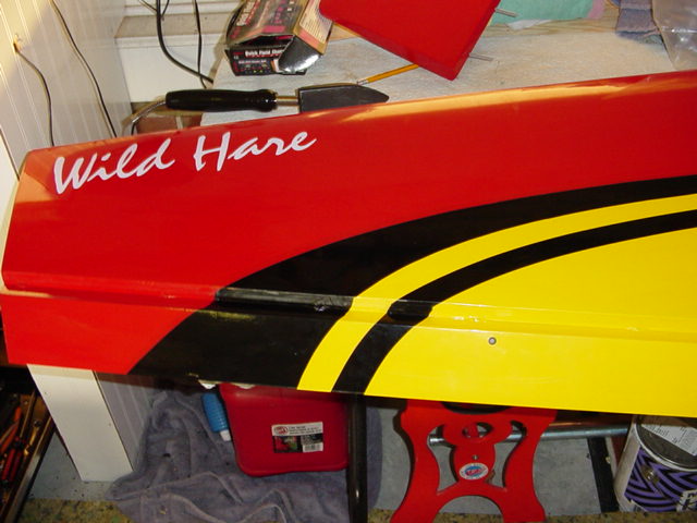

latest up date:
well look what the mail server has put in my inbox:
Message from Wild Hare Hobbies:
Your Wild Hare order has shipped
Scheduled Delivery: 22-April-2004
Shipment Detail
Number of Packages: 1
UPS Service: GROUND
Weight: 4.0 LBS
[8D] boyz the cowl is on it way :

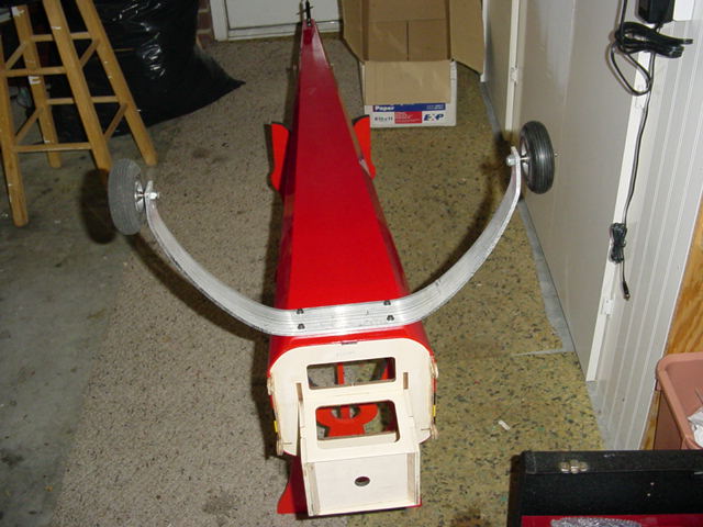

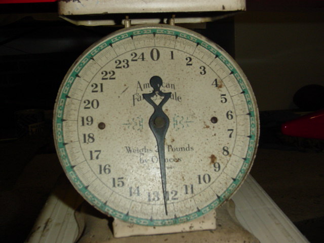

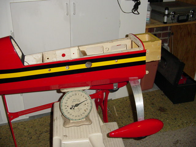

just weighing as i put it together trila fitting. the fuse has 2-8411 in the rear

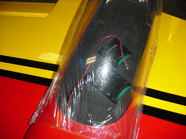

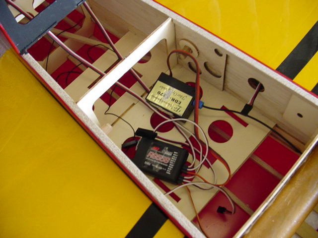

i threw 2 batteries in the canopy area a 1650 4 cell and a 2700 5 cell nmhi
ID:	124645   Click image for larger version
ID:	124646   Click image for larger version
ID:	124647   Click image for larger version
Old 04-20-2004 | 08:42 PM
  #39
My Feedback: (31)
Posts: 7,415
From: Kannapolis, NC
Default RE: Wild Hare Extra arrives
motor and prop/int some glue and extensions and u can estimate your weight for your bird...
2-day I bolted the landing gear on
coated the firewall alcohol/epoxy

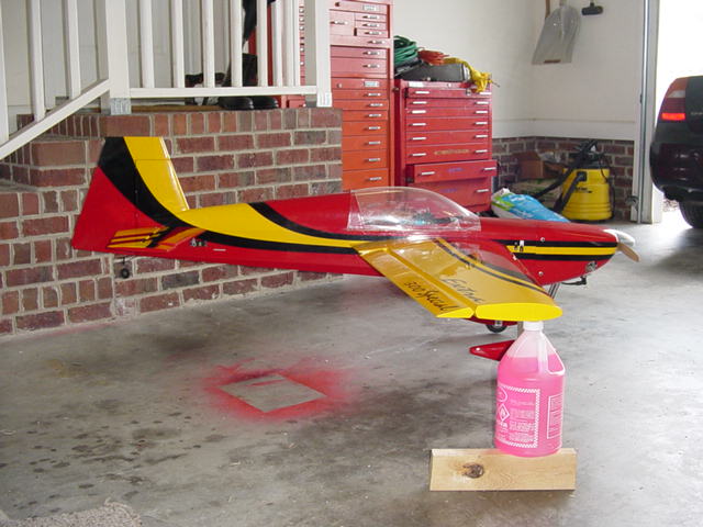

install wheel pants, 3.5 skylight wheels, tail wheel
ID:	124649   Click image for larger version
ID:	124650   Click image for larger version
ID:	124651   Click image for larger version

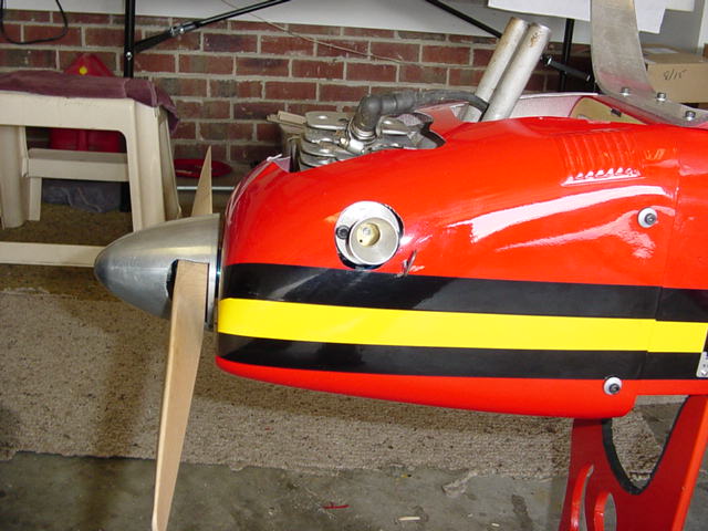

I'm mounting the brison 3.2 with my new cowl
ID:	125772   Click image for larger version
ID:	125773   Click image for larger version
ID:	125774   Click image for larger version

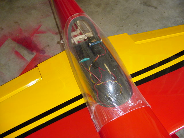

Ok boyz i am by myself and need to trial fit for balance so that i can mount the battery and rudder servo and WH is calling for the use of the wing tips this primative style is what i came up with This is with the 5735 at the front part of the canopy along with a 2700 nmhi.

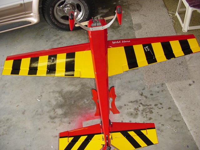

moving the battery and servo to the rear of the canopy achieve these results. NOte the rudder cables are still not installed, and the canopy has not been glue, screwed or however i will put it on..
I always balance mine upside down but i needed to know 1st were the CG was located now that i know were the CG is by the closer portion of the wing i will use the GP balance machine and see how that turns out. i forgot that i wanted to add a pilot so i may have a bogues CG as i just mounted the rudder servo we'll see. i taped on a string on both wings to see were the CG was located for tank and balance purpose...also my things are just sitting in the plane so it would have been hard to keep them in place inverted....
ID:	125791   Click image for larger version
ID:	125792   Click image for larger version
ID:	125793   Click image for larger version
Old 04-24-2004 | 08:09 AM
  #46
My Feedback: (31)
Posts: 7,415

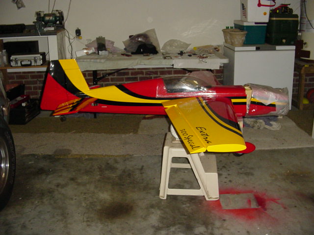

looks like G. I Joe pilot will get to ride in this bird....as a trail fit for balance with him he is 2oz....
things to finsh:
mount
canopy, pilot, blind nuts for hatch, receiver switch, and receiver battery
i am suppose to go to a fly N tomorrow, and class on Sunday so this bird may be down until Monday.
I am right at 17.5 lbs right now.......

boys its time to put it all together, i mounted the battery on the tank i am somewere in the 2 3/4 to 3" range its hard to tell by the way i am doing it but that is very close....
ID:	126136   Click image for larger version
ID:	126137   Click image for larger version

at the field but not for long I got N about a 3 minute flight. I needed 4 clicks of left ailerons on trim step 1 (jr 8103) 3 clicks of up elevator. My motor needed an adjustment on the low end this in turn made the motor idle higher than I could adjust from the transmitter, I did not have a short Allen wrench to adjust this afterwards so I headed on back home. I am going to need a -3 or so to start on my rudder to elevator mix, and about a 5 and -5 to start on the rudder to ailerons mix. I did not have any mixes on for the 1st flight. The plane will fly for 5 seconds or so with out elevator inverted then it needed a slight push. It lands very well and I was flying with a cross wind and it comes right on home like it should. That is about all I know at this time I didn't even do an ailerons roll so I am not sure how the rates on that deal. well I am off to school talk at you all later.....
