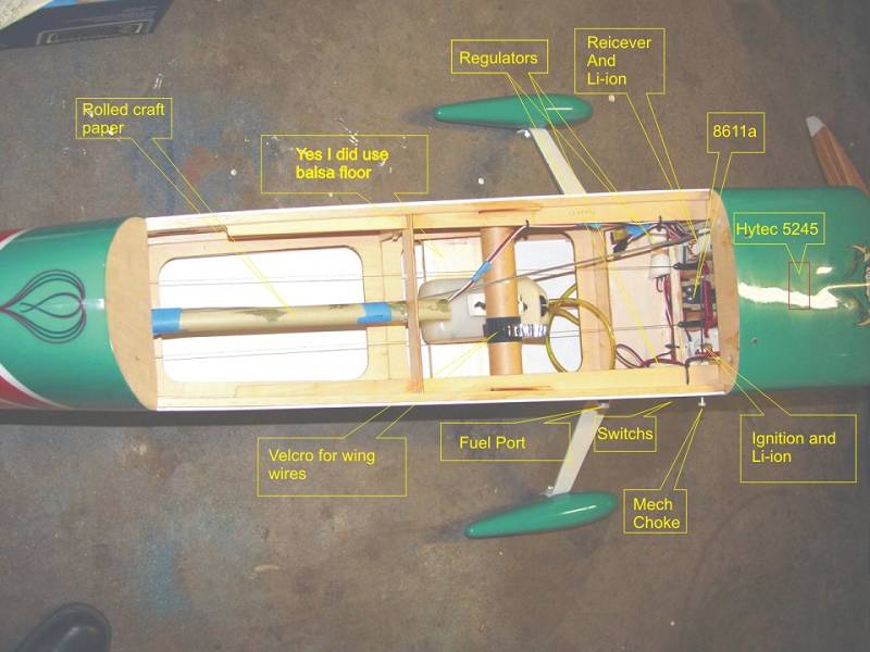

Can some of you post more detailed info of what you used in your plane, engine, electronics, control connectors, etc. I know there are some in previous posts, I just want to make sure I get the right stuff for it. Also the DA50 guys, did you all use 3" standoffs or anyone use longer ones? My plane will be here Wed, but I don't plan on having it ready until next year. New house built, new baby girl, no time and little money, but I just had to have one of these planes. I need to sell some of my glow planes to pay for the stuff for this plane.
