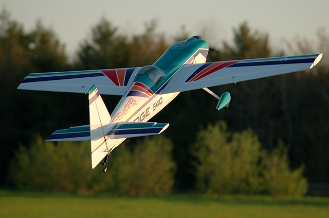

Here's the pics of the new BME 30% Edge 540 II.
It comes with all CF goodies, CF wing tubes. CF tail wheel assembly, CF push rods and FG landoing gear. Just like our new Yak 54. It weighs 8 lbs out of the boxes..Built-up wings and tail feather. 85 sq.in. increased on the wing area. Ultracote covered.
Priced 30 bucks less than the Yak for ARF, and USD 490 for ARC.
Available the end of July. Pre-order will be taken starting July 1st.
For all others who's flying the last version, we will carry all CF products for up-grate.
