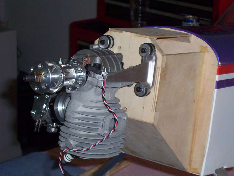

edgeman, did u have to cut the engine box to fit the bme? running a pitts muffler? clearance problems? I was considering a zdz40 but the amout of standoff needed to move the engine far enough forward to get the pitts to work was wayyy tooo much and I wasnt about to heavily hack into the engine box to make it work.. yea yea , I'm lazy.... But considering eventually going to gas and want to find a good fit without making it a hatchet job..
Old 07-12-2004 | 12:30 PM
  #27
Cap232tain's Avatar
Joined: Sep 2003
Posts: 282
From: Palm Coast, FL
Default RE: extreme aircraft cap 232

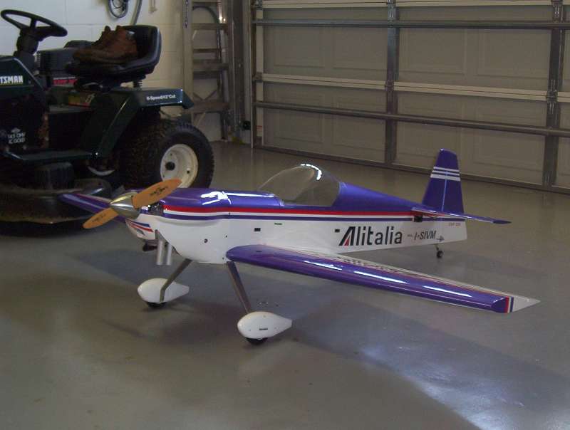

Yes, with the JA Pitts the firewall has to be notched, with the BME bango style no modifications are needed. Actually a simple job, on the cap x I assemble the firewall, on the extreme cap it is assembled and cut with a cutting wheel then box with 1/8" ply. All of the strenght is above the area to be cut, so nothig lost exept a little weight. One of the few small differences between the two is that the firewall needs to asembled on the cap x, just in case you would like to shorten it for some engines. With the BME I am able to use the supplied Hyde mounts with no firewall shortning or standoffs, just have to redrill the engine mount holes for inverted engine mounting! BUT BE CAREFULL, the mounts are slightly offset! Here is a pic of the Cap x, BME 50 JA Pitts. Extreme cap will be the same setup but with BME 44.

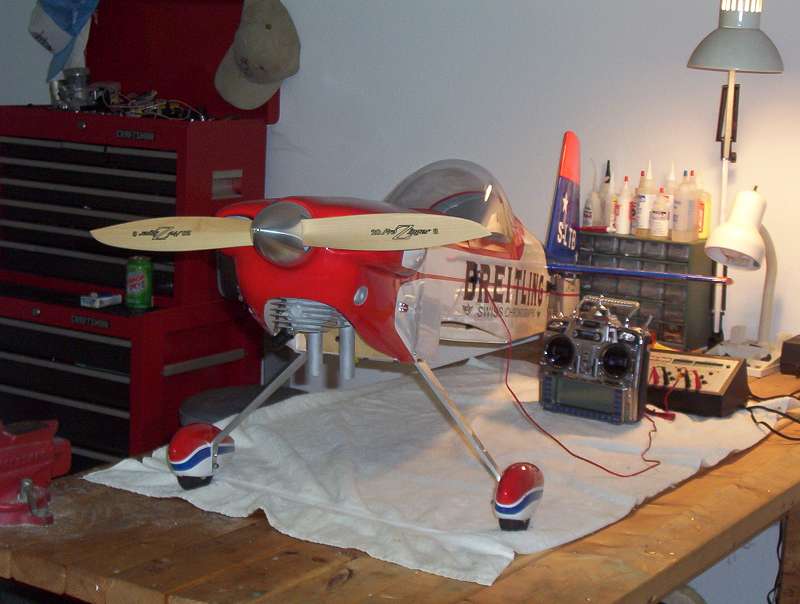

Mounted BME 44 this morning. Here are the pics!

Other side!

Just finished with a BME 44!
