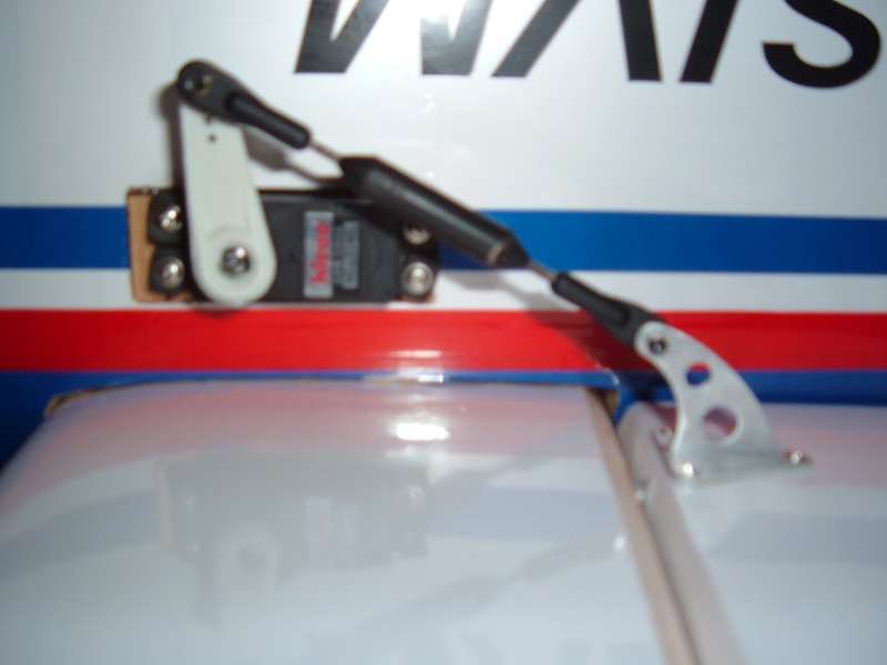

Has anyone had any problems setting up the throws for this aircraft?
I am using the control horns that came with the kit, but can't seem to get enough throw for the maximums on the elevator and the ailerons.
I am nearly an inch short on the elevator and ½ inch on the ailerons. I am also only able to get minimum on the rudder, but that’s because I am using the bar control arm that came with the Du-Bro heavy duty Pull-Pull.
Any suggestions?
Old 04-21-2005 | 11:35 AM
  #95
Joined: Jun 2004
Posts: 86
From: n. las vegas, NV
Default RE: extreme aircraft cap 232
Here is what I did. It may look a little funny but it works great and I get MAX throws!
Old 04-21-2005 | 02:48 PM
  #96
My Feedback: (15)
Joined: Jul 2003
Posts: 166
From: Noblesville, IN
Have you flown it like this? The mechanics don't look good. But what do I know. [sm=bananahead.gif]
BTW, I like the fact that you have used the ball links on both ends, what is that you are using in the center of the threaded bar, I would like to do that.
Old 04-21-2005 | 03:56 PM
  #97
Joined: Jun 2004
Posts: 86
You are right, the mechanics don't look good but it works fine especially since this is such a light plane and the elevators are counter balanced. Those are fiberglass rods made with 2/56 all thread and Hi Tech 625 servos on elevators and ailerons and 645 on pull pull rudder. I have flown it like this many times with no problems.

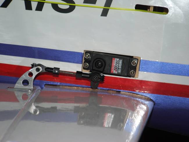

This Cap is my first aerobatic model. As such, I'm not interested in extreme control throws. This is my elavator linkage setup.
Old 04-22-2005 | 08:49 AM
  #99
My Feedback: (15)
Joined: Jul 2003
Posts: 166
Tom,
This looks good, what sort of max throw are you getting at the leading edge of the counterballance?
Also have you flown yours? How does it fly with your throws?
I have yet to fly mine, and worry that I will not have enough throw.
Old 04-22-2005 | 09:41 AM
  #100
TomCrump's Avatar
Joined: Apr 2003
Posts: 7,614
Received 5 Likes on 5 Posts
From: Traverse City, MI
Trip
I'm just finishing mine. I'll check the throws for you, but I won't have a flight report for a while.
They're predicting up to 4 inches of snow this weekend.
I've read that this Cap flies extremely well with the minimum recommended throws. That's where I plan to start.
