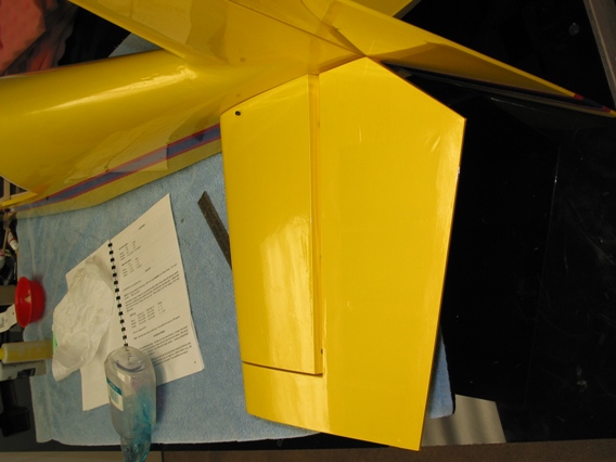

All,
I have the smaller version of the edge and have run into an issue. When my elevator is in a nuetral position. I can only get 1 1/4 inches of rudder throw before the rudder contacts the elevator. Recommended low rates are 1 1/2 inches with 3d being 2 1/2 inches. Obviously i am well short of those num,bers. Has anyone else had this problem. i have included pics for reference

Old 05-11-2004 | 10:17 PM
Posts: 1,297
From: poway, CA,
Default RE: Dave Patrick Edge 540 Rudder throw problem
Looks like some trimming and Pearl yellow Ultracote is in order!
Bummer and its so close too.Go with what deputydog said its the only way now the parts are glued.Looks like you slid the fin into far.Allways measure first,Ive done tha same thing and its not going to happen again.

Old 05-13-2004 | 03:53 AM
Cap232tain's Avatar
Joined: Sep 2003
Posts: 282
From: Palm Coast, FL
Yes, had the same problem. I had done a dry assembly and noticed it and found that I had the rudder into the vert. stab. too far and not far enough on the left elev. I was able to get around it.

Old 06-06-2004 | 09:58 PM
Joined: May 2003
Posts: 843
From: Springfield, TN,
binghamjd:
I have the same problem on mine but I've got mine figured out. check the horz stab and make sure it's completely flush to the side of the fuse. on mine the front rod needed to be bent slightly to make the fit right. once everything fits tight there is plenty of room for travel. let me know if this explanation is not clear enough and I'll try again.

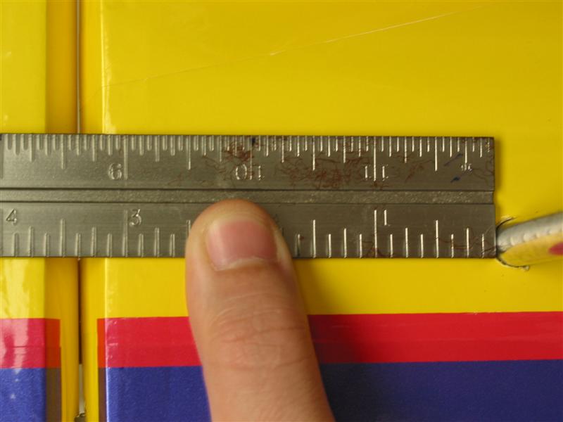

Thanks Miloh... I am flush as can be. if it isnt too much trouble, I attached a picture measuring the tube the hing line onf the rudder. Does your measure the same?

Old 06-07-2004 | 06:40 AM
Joined: May 2003
Posts: 843
I'll check it as soon as I get in from work this evening.
Miloh.
Old 06-07-2004 | 07:59 PM
Joined: May 2003
Posts: 843
seems to be pretty close
Miloh.

Old 06-07-2004 | 08:24 PM
Posts: 17
From: Fredericksburg, VA
Thanks Miloh. I ask Dave Patrick to do the same thing and he wouldnt. Thanks again
