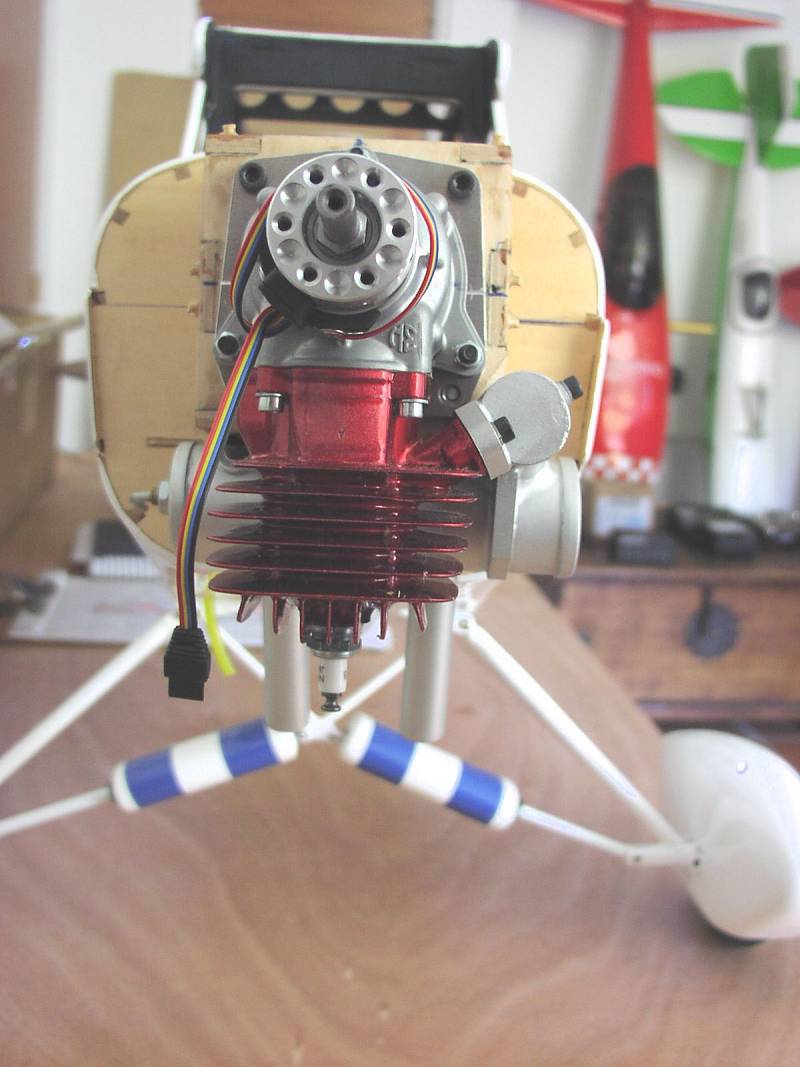

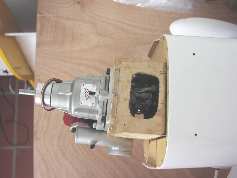

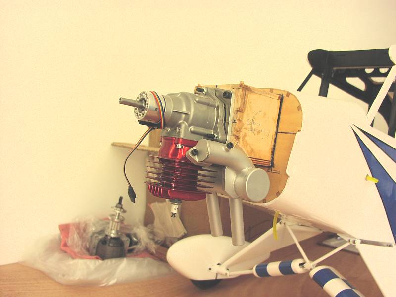

I have a 3w 28 in my new DP Clipped Wing. Would it be extremely over powered?. Looks nice at least...
Thanks !

F101 - Could you post a picture of the 3W in your Cub with the cowl off ?

Yes, I will post the pic. later today. I had to build an engine box for it. I hope it is not really too overpowered, was quite a job...

It sounds good!. A little throttle management always help. I will use Mens S 18x8 . I have some pictures for you here.

That looks great. I'll bet that you're going to be pleased with that combination. Thats the first blue and white clipped wing I've seen. It looks good.

Fl101 - Thanks very much. Nice set up.
