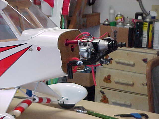

Flyn,
Keleo exhaust arrived yesterday. He does real good work. The fit was perfect. I still have not glued in the side windows. I think I am going to attach them with screws. I have screwed on the front windshield. As I said earlier if you're going with the keleo exhaust order now, there is a four to six week wait. I think this exhaust actually made the twin sound better, if thats possible.
The toggle switch you see is for the on-board glow driver. I have no idea why I mounted there
Post some pictures of yours when you can.

Thanks for the fast response. That looks great!! Again, looks as if you did an outstanding job. I actually ordered my 1.60 twin yesterday and should receive it middle of next week. I just got off the phone with Keleo and he said there was one more left, so I ordered that today! :-) My bird is not as far along as yours is but I will post some pictures. Ill take them tonight. What spinner are you going to use? The Vortech? Are you planning on turning a 18x6?

a shame you have to cowl that beautiful work of are up.

Thanks, yes a 3 inch vortech and a 18x6 zinger.
Thanks icrashbipes, they should make a clear cowl
I'm unsure about what size air exit holes to cut in the cowl, any suggestions? I read where someone did not cut any.

Your exit hole, as a rule, needs to be twice the size of your air inlets.
I wouldn't take the chance of not cutting them, that motor is too expensive.]
Really depends on how "scale" you want to be.
When your running rich it wont matter that much, but after you get it tuned you run the risk of shortening the life of your twin without a place for that hot air to go.

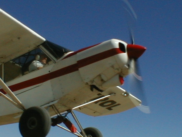

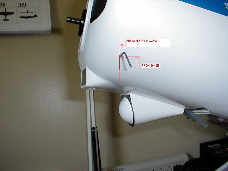

Here's what I did on mine. If you look close you can see the opening, similar to the real one. Cut it at the firewall area from exhaust over.

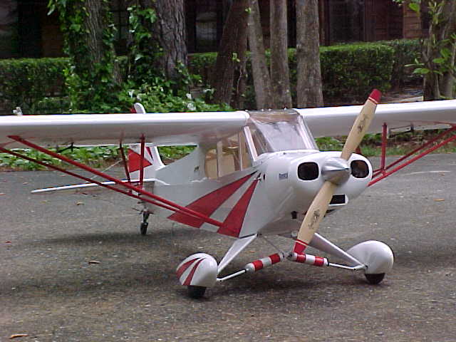

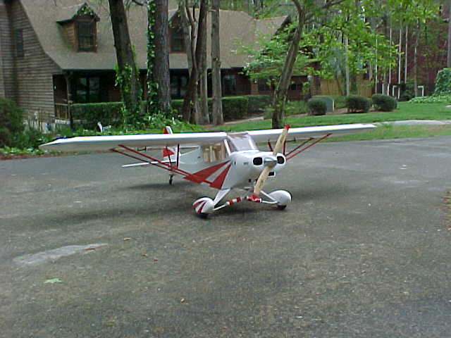

Okay, here it is. Maiden tomorrow weather permitting.
The book says balance range is 4" thru 4-7/8 " behind leading edge. It says the ideal cg is 4-3/8". Mine balanced at 4-1/4". I should be okay, right? This was without adding any weight.
The book also says to program in quite a bit of differeintial. Alieron throws are 1 3/8" up and 1/2 " down. Thats alot of differential. I have never used that much before. Looks kind of strange. Any comments?
The struts are going to be time consuming to put on at the field but they look nice.
Any comments or tips regarding the maiden are welcome

Hill, nice job, good luck with your maiden, it should be uneventful as this is a great flying airplane. The CG where you have it should be fine, also why do you have to assemble the struts? I have the full wing version and leave them on all the time, disconnecting/connecting only at the fuselage. I reinforced the bottom half of the kit box with duct tape and lined the floor surface with medium foam and now use it to transport and store the wings on edge and it's a perfect fit! By the way I don't use differential on mine, I mixed 12% rudder with aileron and that takes care of any yawing.

Thanks Orvel, good idea on the struts. I have 20% rudder mixed in. I think I'm going to do away with the differential. If it yaws ,I'll lean on the left stick a little.

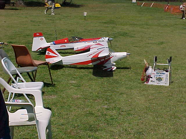

I got in 3 flights. It maxed out at 7300 with a Zinger 18x6. I riched it down to about 6800 for break in. I know its a Cub but it was very slow and sluggish. I flew pretty much full throttle the entire flight. Once its broken in I am going to experiment with props. I am real curious to hear what you and others think of this combination!
Don't misunderstand me it was a great flying plane, I was just expecting a little more power.
No in flight pics but my son did take some of it on the ground.
