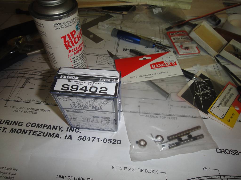

need a arf, looking at the e-flite p-18 , my dp p-18 is going ok but the landing gear from the hh 1/4 cub dont fit the dp p-18, fuse is not as wide , may get out the hammer and start bending the gear and yes paint will flake off and IAM NOT GIVING UP , some day it will fly , even if glow fuel goes to 50 $ a gal, thanks frank
Old 07-17-2011 | 01:16 PM
  #1253
Joined: Jun 2007
Posts: 574
From: Freedom, PA
Default RE: Dave Patrick super cub
Frank bolt that gear on &figure out what needs done to make it work, you got something I've been drooling over for the past few years, don't let the L/G stop you from finishing it. The cross brace and outer sliding strut may need cut down a bit, don't bend things up!

took a look see and no match , still hanger 9 set will fit with some mods new pic coming thanks frank

pics servos i am going to use and axels close but no cigar thanks frank

I used the same gear on an old H-9 Super cub, we just shortened the shock tubes, and drilled new holes in them. Worked great for us.

By the looks of the pictures, Frank needs longer tubes than he has there. The fuselage is a bit wider than most. It might be a good idea to call Wm.C. Wallace to see if they can make new tubes for it.

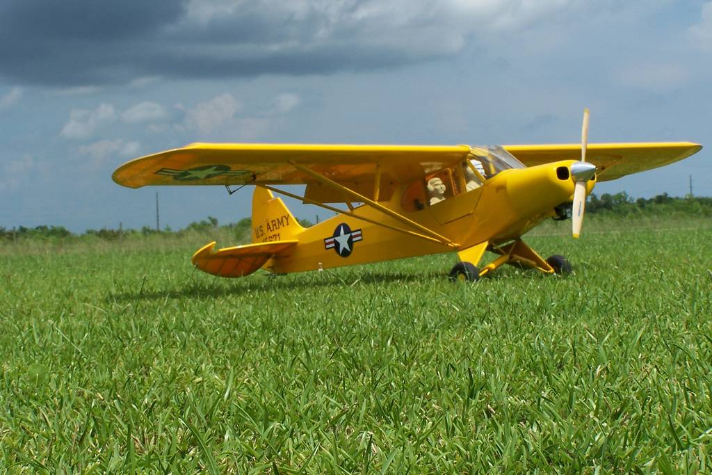

Just completed repairs on a DP Pa 18.A club member had crashed it a few years ago an at that time it had only @ 5 fights on it.It now fly's as a L 21A.( the best of both worlds).As soon as I recieve flight photos I will post
Crazystick

Looks nice. So, what did you change about it other than putting in the door? Did you recover it with fabric and dope?

The wings had very little damage,repaired tips. The nose was broken off,repaired replaced Cowl and windsheld.The damaged area was recovered with utra-coat. It is powered by a CRRC PRO 26R which turns a 18/6 prop.So for it has 7 flights on it since repairs. The best thing was that I got the airframe for only $200

Oh,I almost forgot,The door was put on to hide the switchs and the fuel dot
