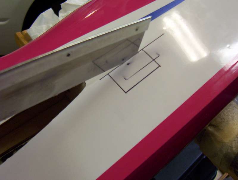

Default RE: Fliton EXTRA 330s Freestyle ARF

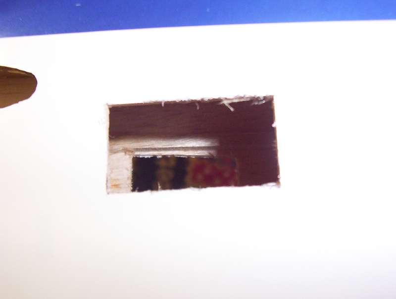

Got mine and it looks good. Got the servos on order.
2x HT5245's in the tail (push rod does not look good for 50° travel)
1x HT5625 on the rudder(if this thing does not KE loop I don't want the rudder servo to be the reason)
2x HT635's on the wings. (Don't think I will need more than 30° on the wings? Whatever it takes to keep it from torquing should be enough for me)
Plan to mount the SA100 inverted, not sure if I will use a pump or not yet--thinking of a Vp20 pump and a long straight pipe to keep the plane clean.

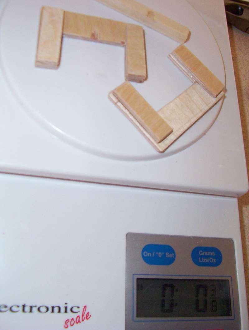

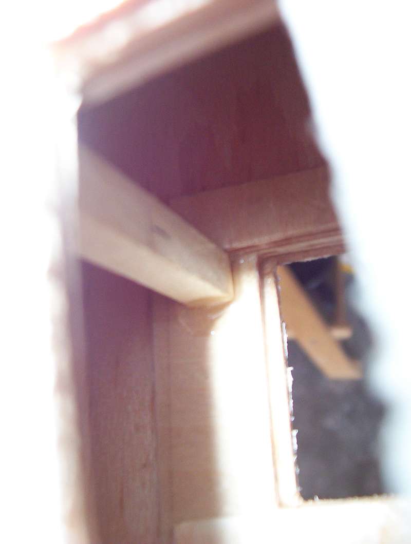

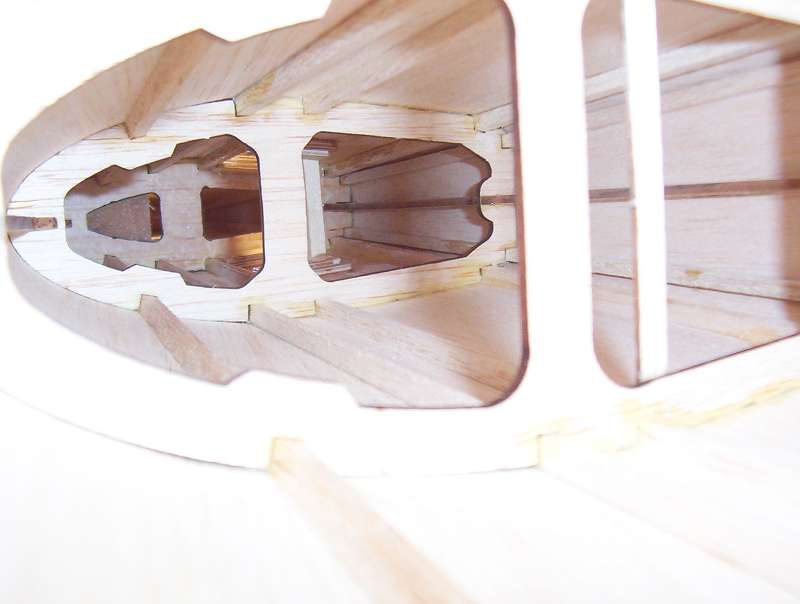

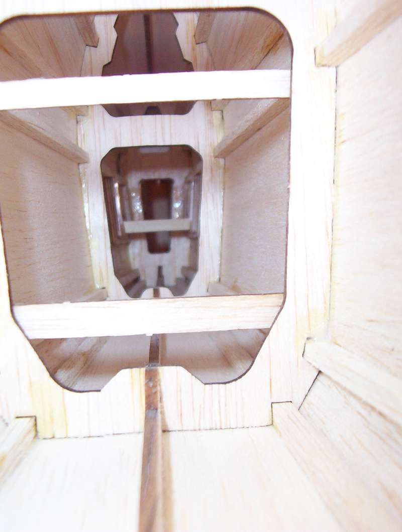

The ARF comes with a push rod system. I chose to use 2 Digital Mini MG's in the tail (5245's). I don't have the servos yet, but this is what I did to the airframe...
1) I wanted to cut in a little higher, but there was a rib traveling to the tail that I did not want to cut into, so I went just under it.( see picture 2)
2) Used 1/8" ply and cut out U shape that runs to rib and back to tail cross section piece.
3) Ran some 1/4 square across to tie everything together.--pictures don't show that I have 2 in instead of 1.
4) Used 30min epoxy
I am no master builder, so take this example as just what one person did--not as instructions of how to do something like this.

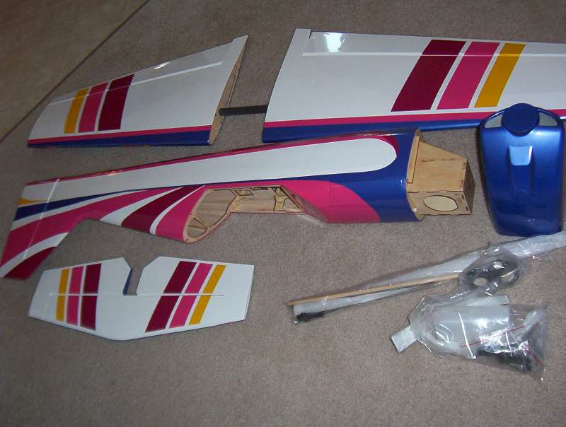

This extra looks like an amazing plane and i cant wait to get one. I have two problems though.
1. I only have an OS50SX (which will just have to do for now until i can afford something bigger)
2. Although i have been flying for like three years now, i have NEVER put together a single plane in my life.
not built one, not had to fix one, not even put together an ARF (sad i know), but i had good flying buddy freinds lol
Anyway its gonna be interesting to say the least trying to piece together my extra, but hey im desperate and it cant be that hard.
there are lots of sites with guides on how to assemble them anyway that i have been reading and if i get stuck you can be sure that
