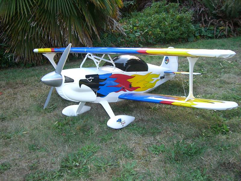

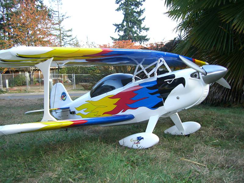

I just finished mine and had an O.S. 160FX laying around so I threw it in. Have a APC 18x6W prop on it but haven't had the time to maiden it yet. All Servos are high torgue metal gears except for the rudder which is super high torque. Plane seems to balance okay on the recommended CG but I'm not real happy about tying the ailerons together with rods. Four servos would have been much better. Anything you guys can tell me about maidening this thing would be appreciated.
ID:	554135   Click image for larger version

Thanks for the tips. I've flown a Super Stearman before so I'm VERY familiar with the slowing down on final!!! LOL Take a look!
http://media.putfile.com/Death-of-a-Super-Stearman-90

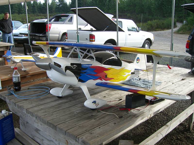

Thanks, Actually I sprayed the inside of the canopy with flat black Testors model paint and then masked the outside and sprayed the edges with gloss white. Looked way too plain with the clear canopy and all of that white cockpit showing. Just did an all-up weight and it comes in at 13lbs 10 ounces. The 160 puts out a lot more thrust then that with the 18x6W on it so it should do anything I like within the parameters of its design. I originally bought a BCMA 40cc gasser for this plane but decided to put in my Great Planes 27% CAP 232 and the 160 in this. I think I'll get a lot more use out of the 40 in the CAP. If you like the GFI45 you should check out BCMA.
http://www.bcmaengines.com/ I bought a 40 and a 26 from Adam and they are great engines at a great price. Adam will give you outstanding service also. He custom made the stand-offs to match my firewall to thrust washer distance for free AND I got a free Jersey fuel tank for buying two engines. Glad you got your glitching problem solved.

Finally got the maiden in. Plane took off strong and flew good at half throttle with the OS 160 in it and the APC 18x6W prop. Would climb hard if I applied throttle above half though. Guess I need to put a little down thrust in the engine mount. Landing was definately hot but I made it after the third pass. I'm going to need a little practice landing this thing. Flairs nicely after it slows down but takes quite a while to slow down. Funny thing was that I tried to turn it on the ground after it slowed down considerably and it flipped over on its top. No damage but you definately need to slow WAY down before turning around. Shot some video but it's pretty uneventful. http://www.rcuvideos.com/view_video....e=&category=mr

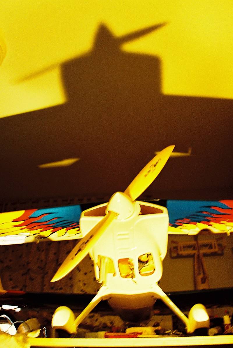

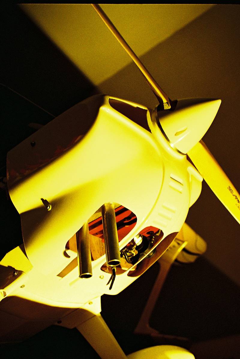

Mine fairly flies on 14 lbs of total weight, I´m still dealing with the GF45 needle settings. The FMA Opto4 optical isolator solved the glitching issue.
[&o][&o][&o] Sadly I crashed the landing gear so I need wheel fairings and cowling spares, have any of you mainded where to get them from?
ID:	630944   Click image for larger version
