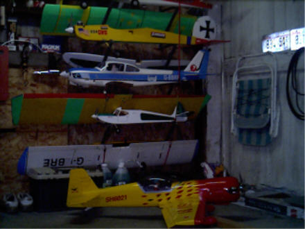

61 would probally work fine in the Sukhoi. A tad heavy on the wings, but its a fairly beefy Plane, and a tad larger than a normal .40 size. Here is the Phoenix Sukhoi in my Hangar with a Saito .72GK. Just right I think, but this post is about your Plane and not mine.

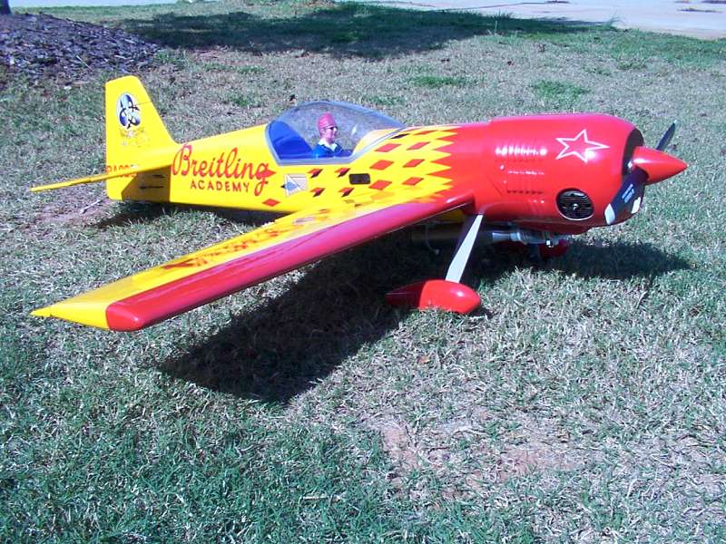

I think a .61 will do fine.
I started out with a .46 FX on first few flights. I did well but I felt the power was low. I took it out and am now flying it with a MVVS .77 and mini pipe set up. I like big props and this thing turns them no problem. I'm using a 14x6 and it has tons of pulling power and will accelerate going vertical. I also ran a 15x4 before and it also ran good. Just a bit close on ground clearance.
It is a little bit heavier but no different nasty habits. I used the same engine mounts and havent had any problems yet. It fits nicely in the cowl since the cowl is a pretty good size.
