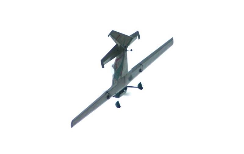

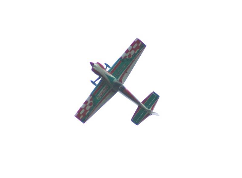

Read my posts!! I fly it with a YS .63 and a 13x4W prop and it's awesome!!! Check out my video of the WM CAP 232 46R on Members Videos!!
