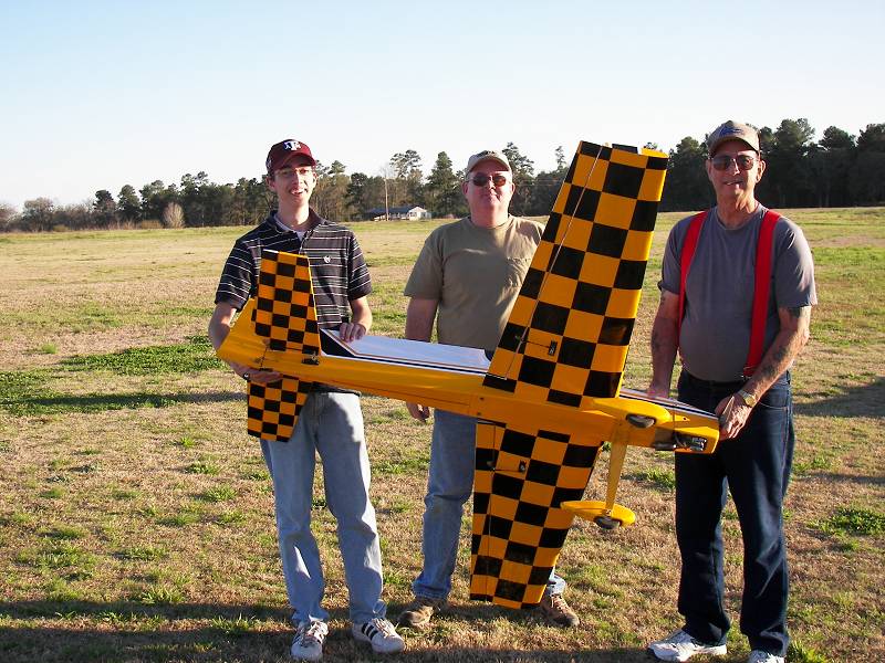

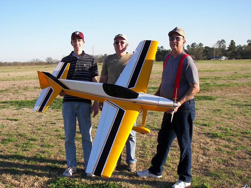

Don, Med, Tim, etc.
Okay, I posted these pics in the JERRY's BIG BOY thread to show everybody my color scheme for it. Here are the pics to show everybody my BALSA NOVA 120. Son Kyle, Ronnie Rushing and Doug Cockerham............. My Flying buds.

Don,
No! This is a re-covered ARF! Everywhere you see red on the ARF, my son replaced it with yellow. The rest is the same..... Saito 120 with an APC 16-6. JR 10X with JR Sport 125MG servos. Flies great. Snaps really low to the ground and is very predictable. This thing knife-edges low and slow or wide open....... Makes no difference. I'm going to fly it for a while longer and probably put it up for sale later this summer. Have another toy to take its place but I'm still working on it......... Surprise! BTW: I have to thank Kyle for my covering job on this one...... Pretty good for a 17 year old! One other thing: I cut off the bottom third of the firewall side to side. I then angled a piece of lite-ply at a 45 degree angle so that the muffler would angle straight back. This points the muffler back and down and the plane stays fairly clean.

A Saito 120 !!!!!! No wonder you questioned me putting a TS 52 in mine. I have a 120 in my Venus II and it weighs 4 lbs. less than my BN120. Don't you know your are supposed to take the manufactures advice and at least double it

Don,
I thought long and hard about it but my particular kit was just really light! This thing flies like a darn foamy..... It' just under 9 pounds. Most of them aren't that light and I didn't feel like beefing up "air!" I'd be dead serious saying that this thing would probably blow apart with a 180. I have built three of them and they were all over 10 1/2 to 11 pounds. You must have gotten one with some dense wood that could take the weight of those bigger motors. We used a MVVS 26 gasser a Saito 150 and a Saito 180 on the others. The one with the 180 got a Saito 220 to break in for a while and it was just plain insane...........
