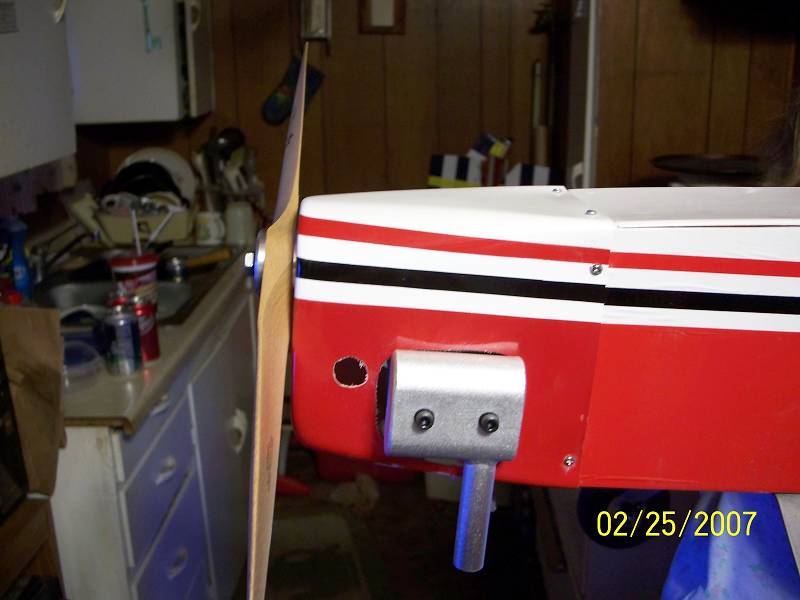

And here's more proof that the BN 120 will fly good with any engine and at any weight. I started out with a MVVS 26cc and a tuned pipe 13.5 lbs. next was a Saito 270 twin, 16 lbs. including 18 ozs. of weight in the tail. Next was a Taurus 52cc 15.5 lbs. Next was a Brison 2.4, 13 lbs. It flew best with the Brison but all engines and weight were acceptable. My sentimental favourite was the 270 twin.
I ordered a replacement motor for my BN. It had a ST 2300 on it but every second or third flight was a deadstick. As much as I enjoy making everybody say 'Oh Oh' this was too many deadsticks. So it's getting a BCMA 26 gas engine. The BCMA is about the same size and weight as the ST with the exaust and ignition. Can't wait to get it in the air.
Joined: Nov 2005
Posts: 16
From: sioux falls,
SD
Have you installed the BCMA 26 yet? If so how was the cg. I am working on the same set up and found that I nned to put the batteries back in the fuse behind the wing. Also I am going to try a APC 18x8w how about you?
No, it's here though. I've been working on getting the Bling finished with the bcma 62 on it. The ignition battery for the 26 will be just behind the cg to make up for the aluminium spinner and ignition module. The plane should only be about an ounce heavier than it is now.
It's installed.
I put an 18x6 on it. Still waiting for the spinner. I ordered the wrong size the first time. I put the batter pack just behind the cg to offset the weight of the ignition module. Otherwise the engine is the same weight as the G-2300. I ended up butchering the intake side of the cowl a little but it's functional. I've been using the Great Planes gas engine kill switch but they have to be modified for use with this engine. The switchs, ignition, and battery have to be wired in series. I'm going to post something about this in the BCMS sig later.
