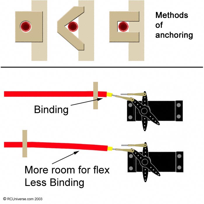

Hello,
I am building a Thunder Tiger Stick .40. I could not get the wooden pushrod assembly to exit the rear for the elevator of the plane and move back and forth in a smooth manner. It constantly stuck. I tried bending the pushrod so much that it is unusable and needless to say all of that bending never got me anywhere anyways.
I ordered a flexible pushrod assembly that will be able to glide past all the kinks and give me a smooth operation. My question is, is it it okay to use a flexible pushrod for the elevator? Will this cause any control problems? I ordered the accu-glide assembly made by Great Planes as well as a flexible pushrod assembly also by Great Planes. What should I do?

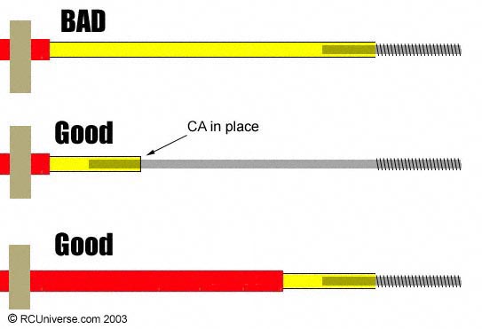

No problem. Just be sure to anchor the outer tube at both ends and at least one plece in between (Every 6" or so is better).
Also, be sure not to have more than an inch or so of the inner tube protrude from the outer without metal reinforcement

I like flexible push rods...alot. I only glue the outer tube at one end so it can expand and contract inside the plane without binding. If you glue it at both ends the outer tube will develop curves because it will not move through the structure.

i agree with piper chuck on the fact that the outer tube can bow if you only secure one side. i will secure both sides particularly if i am using to span the length of the fuse but if it's really inconvenient and for shorter distances such as the throttle linkage. i find that they work wonderfully!

That being said, some people like them, and it is not a bad idea for you to try them and find out for yourself. As mentioned above, the more places you anchor the outer tube, the less flex you will have inside the plane resulting in greater precision.

1)there are differant flexsto all rods sold , look at the colors when your in the store , you will see some will bend easily other offer more regidity .
2)you can get creative to make sure your model is more secure -as min flyer suggest red outer , yellow inner , you can even cut a small piece of carbon fiber rod to add major regidity at the exist point and over the red portion , this will even make it stiffer .
3)finally you can add some non offensice descrete triangle stock to the "red outer tube" attached to the fuse to add more support .
