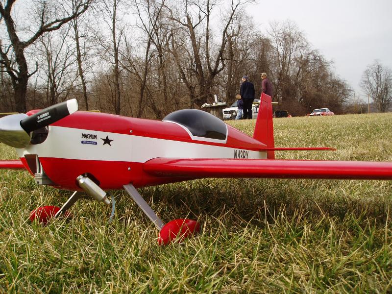

I have an OS46fx sitting in a Tower Voyager and am thinking about moving it to the Extra 300S. In the description on the Tower Hobbies website, it says that the engine can be mounted rigth side up. I have done a search on this plane and the only posts with pics that I can find show the engine at 90 degrees or inverted. Can anyone out there confirm that the engine can be mounted upright? Before you say that moving from a Tower Voyager to an Extra is too big of a move, this is not my primary plane. In fact I have 6 planes, and am just not having fun flying the Voyager. It sets mostly on the shelf while I take the others out to the field. Will probably sell it at our club swap meet. I am just looking to upgrade the plane that I have the 46fx in.

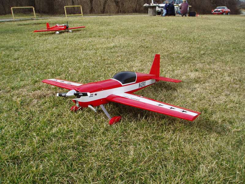

Here is a link to a post I made about the phoenix models extra 300s. I took a bunch of photos and included them. I'm guessing that you wouldn't be able to mount the engine upright without cutting the cowl up pretty bad. My engine mounts came pre-installed. If you have any other ?'s I'd be happy to help.

Here's a few pics of it. I love this plane. Worth every penny of the $109.00!!!

dkf1979 - Thanks for responding to my question, but I had already read through that thread. From what I can see, mounting the engine upright would look pretty ugly and you are right about having to cut the cowl up quite a bit. It just bugs me that tower indicates you can mount the engine upright. I just can't see an extra, edge, or other aerobatic planes with the cylinder head sticking up through the cowl. What were they thinking[X(]
