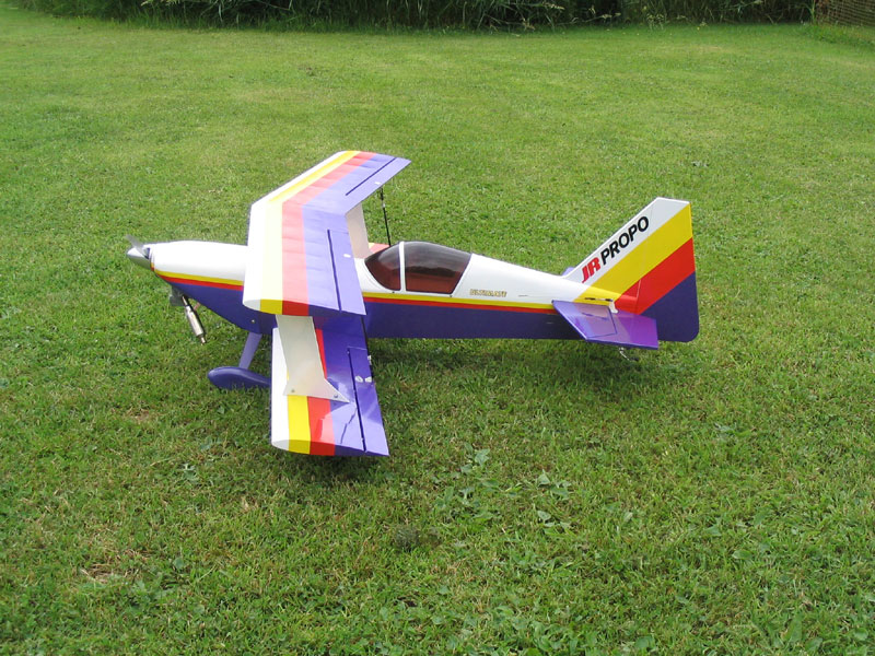

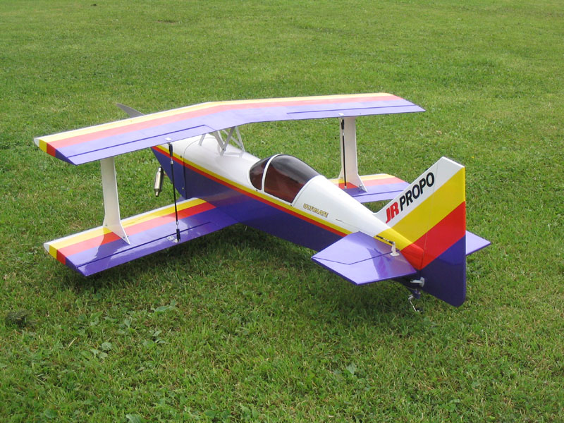

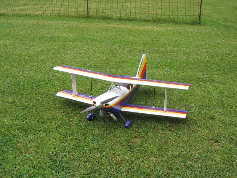

It was overcast with very blustery wind today, but I put in a couple of flights and it is a really nice flying plane. Rolls are very axial, knife edge flight requires very little rudder, snaps are quick withouth over-rotation and it lands easy - even in the wind. I'm running a Magnum .70 on 10% Omega and it easily climbs vertical out of sight.
