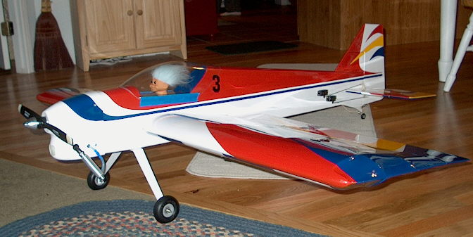

I am just finishing a U Can Do 46 and the plans instruct you to put the control horns on the tops of the elevators and then use a reversing Y connector. Is there any reason why I couldn't put one of the horns on the bottom of the elevator and use a standard Y connnector. My LHS is out of reversing Y connectors and I was hoping to fly it this weekend since I already have a standard Y.
Thoughts appreciated
dave

I had mine set up originally with a Y harness and one of the horns up and one down. It works, it's just set up in a weird angle, but it does work.

Use a reversible Y-harness with the Futaba 7-CAP . Believe me ,, it's better. You can't adjust elev trim equally while in flight with the 7-CAP. You do have aileron mixing that works perfect. But Futaba doesn't put in the correct elev mix features in radios less than the 9-C, etc.
And no,, I didn't post this because it's my thoughts or idea. Got it right from Futaba's website.

Thanks for the info. I found exactly what you stated in the FUTABA FAQ on the 7 -cap. I will use the Y harness
