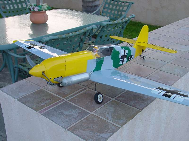

I am happy to announce that my 2nd Model Tech me 109 has successfully flown 4 flights and one with a botched takeoff. On the first day, the first flight went great. The second flight endend with a gournd loop on take off due to to little air speed on take off. I had a hard time getting air speed due to the fact that I could not keep it going straight on the runway. I fixed this problem with a new tail wheel and a 10X6 Master Air Screw prop. I started with a 9X6 APC, and it made the plane facter but a lot less stable. I am runnign a 35fp in the plane. Even with the M.A.S 10X6 I am getting 11,540 rpm according to my tach. The plane is a real screemer. The RPMs seem a little fast to me but it is a new and nice digital voltmeter and tach, so I guess it is correct. If any of you think differently I would like to hear your opinions. After some minor repairs, the second day saw three smooth takeoffs and landings!!!! The third landing was smooth but on the taxi back to the pits I bumped the prop on the edge of the runway and the engine started running backwards!!!! I hit the throttell and the plane started backing up. I had never seen this before. Some of the more experienced people at the field said they had seen it and it was rare but no big deal. Any way, I love my me 109!!! I hope that I keep having such good luck, I will not pretend that it is skill. Good luck, I would love to keep hearing hearing your experiences with this little rocket ship.

Today I was FINALLY able to get my .40 powered .25-sized Me-109 in the air. It took awhile to find a field with short grass and suitable area to fly it, but it was worth the wait.
Eveything everyone has said about this plane has been true. I experienced the tendency to dip a wing right after takeoff because, like everyone said, it wants to fly before it's ready. My plane was wanting to nose-tip which I think is attributed to a still-forward CG. I flew around half-throttle the whole time without incident. Full throttle gives me a screamer. I decided to tone it down for the first flight, just to get a feel for the plane.
The handling is sprightly to put it lightly! I had the low-rate throws set lower than the handbook suggested and still thought it was touchy. Unfortunately, it was getting dark when I had to bring it in dead-stick (having some engine woes) so I didn't get a chance to fire it up again. Landing was a cinch. Once the plane settles into ground effect it sets down nicely. I'm definately looking forward to more flights.
