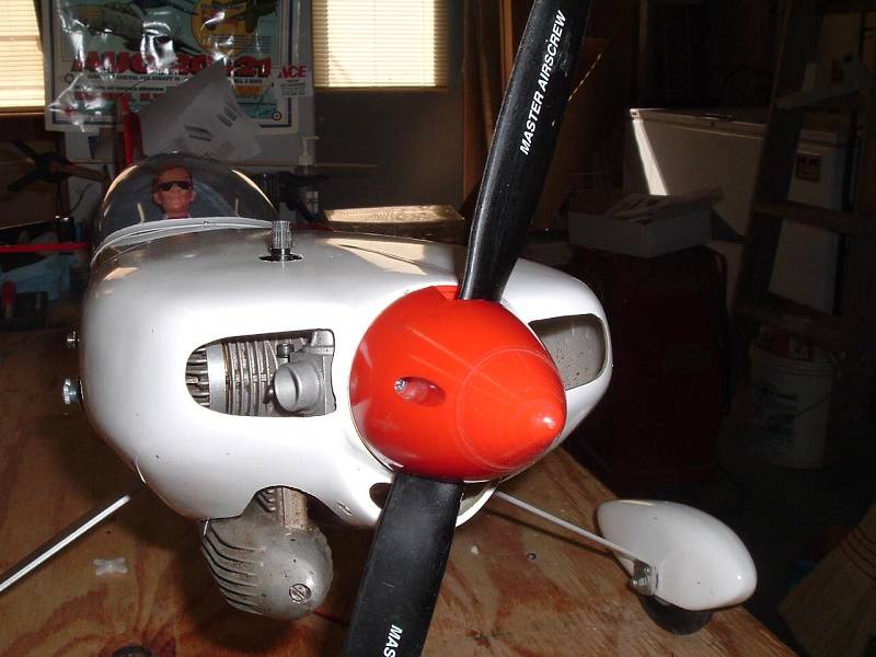

Here is a couple of pictures of my Rocket...very similar to the look on the box except I tinted the canopy. The The picture of the exaust exit hole isnt that great but hopefully you can get an idea of how much airflow I will have. I am going to maiden it tomorrow....wish me luck!!! I hope to get multiple flights in to get a good feelof how the plane reacts. I jut hope the weather holds. Sounds like it might be jsut a bit dicy on landing...oh well by then I will be committed!!!

Heavythumbs, that looks like an O.S. 46AX installation, correct? If so, how did you CG come out? I see you put all your servos in the standard locations, some are reporting aft CG with your setup. I'm planning on putting my rudder servo forward and using a pull-pull system but don't know if I need to or not. We look forward to hearing about your maiden, best of luck!

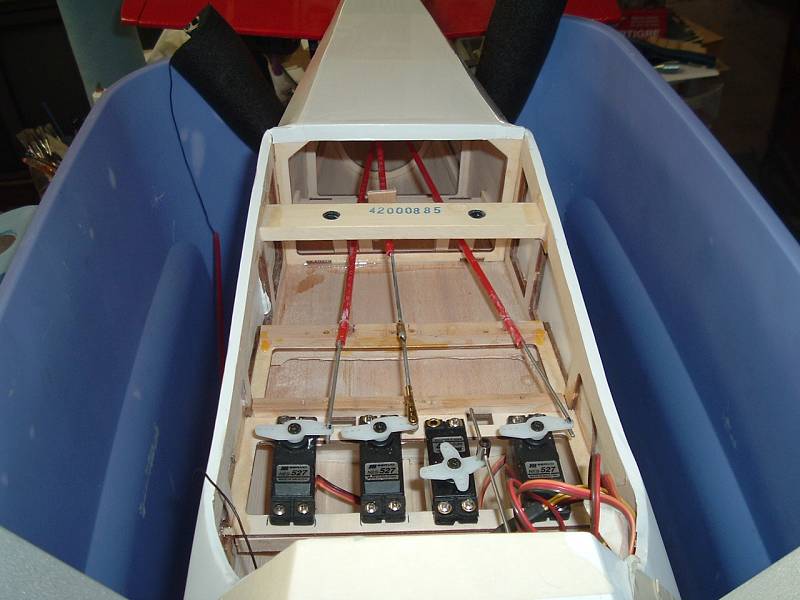

I havent totally got the CG done yet. It is tail heavy...I cut out the servo holes before I had heard that there were issues with this engine and the center of gravity... I would put as many of the servos foward into the fuse as possible. I really dont understand why they did it that way anyway. There is so much room in the fuse that it really makes more sence to hide them inside for a more sleek look. I will be adding weight to the firewall as needed. I will post later today or tonight just how much weight I needed to add for the CG to be correct.

I would strongly advise against the servos all inside. I did it, way too nose heavy, took too much weight to get it to balance, and the landing gear isn't all that hefty to begin with. I just recently moved the elevator servos to the rear, left the rudder servo inside next to the throttle, and didn't add any weight at all to balance. It flies much better, but still seems heavy / fast on landing. This picture is with all the servos mounted in the inside, which was what I felt was the cleanest looking installation. From left to right, elevator, rudder, throttle, elevator. This also doesn't require the use of a servo reversing cable.

Bingo field, what engine are you running? Is it a 4 stroke? I was thinking to put the servos inside with my lighter engine. to help the CG issues without having to add the extra weight. I guess it really boils down to how heavy the engine is.
#82
Evolution 46. 2 stroke. I also mounted the battery behind the servos, to the rear. It says it is supposed to be 13.76 oz w/o the muffler. I don't have anything to weigh it with...

Oh wow, ok. For some reason I thought you had a 4 stroke!! I have my battery mounted right above the fuel tank in the front and it still seems tail heavy. That is why I was wishing I had put the servos inside the fuse. I will check out the CG fairly quick now my couriosity is getting the best of me..I am studying for a test tomorrow morning and am trying to stay away from my plane but..oh well it is just a test!!!

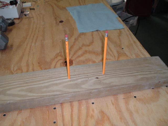

Ok I just got it. I will say it is just a tad bit tail heavy. I will put a 1/2-1 oz. on the firewall and I bet it is perfect. That was a lot closer than I thought. I checked it right to the sides of the fuse with the plane upside down. I am assuming that is the correct way to get the CG for this plane. At least what I was told and have been practicing.
#85
My book says 3.25 - 3.5 in. from the leading edge, at the fuselage sides. I am right at the 3.5" mark, and mine, to me, seems nose heavy still. Here is my CG Machine. If you use new pencils, the erasers cushion the point of impact just right. This probably would have to be modified for heavier planes, but works well up to 60 size anyway. I use about 1 - 1.5" of masking tape on the wing where I mark the forward, center, and aft of the cg, this way when I am done with it, I don't have to erase ink or marker from the wing.

Thanks for the picture! I rigged up a CG like yours and ended up needing 2 oz on the firewall for a nice balance. Now it is just waiting for tomorrow for its maiden!! Hopefully the weather holds.

Has anyone thought about stripping the red off and making a more customized finish? Bingo, it appears you resolved your problems with it. Brought mine to work today to go flying right after work. I WISH TO HECK I COULD GET AROUND THIS DAMM PROXY SERVER SO I COULD POST PHOTOS !. Oops, my apologies for shouting, Ya'll have a nice time flying, Seeya, MM

Nice and cheap how that CG machine is, eh? Easily adjustable also.

Did you guys carve out the holes on the front of the cowl? The ones to the left and right of the spinner, and the crescent shaped one below? I also understand that you need 2 -3 times the area for heat to exit, in relation to the air coming in. I can go through the tank at all speeds with out any problems. You guys and the planes that glide when you flameout, and my brick that keeps running.... I am also running the hotter A3 plug, as my motor won't run horizontally without it. Using the standard plugs, it would die at half throttle, acting lean, and it does the same thing with the A3 plug, and the pitts muffler. I had to use the stock Evo muffler. The stripes help me tell the difference from top and bottom of the wing.

Bingo.....your man in the cockpit is different to mine.....mine has a little red hat on.............he kinder looks like a builder on a construstion site...how many differnent men are in use in the rockets i wonder??......could the man inside the cockpit make all the difference to the way the plane flys?????LOL....
