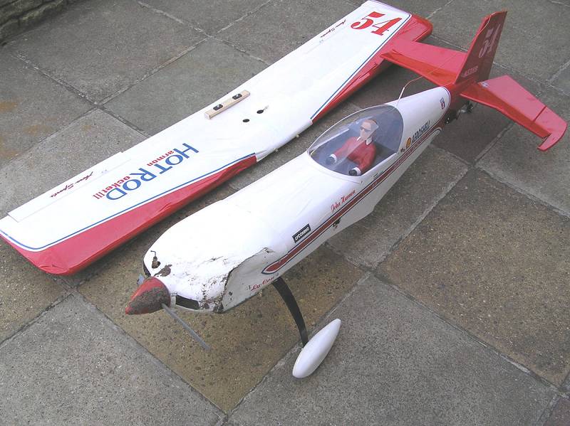

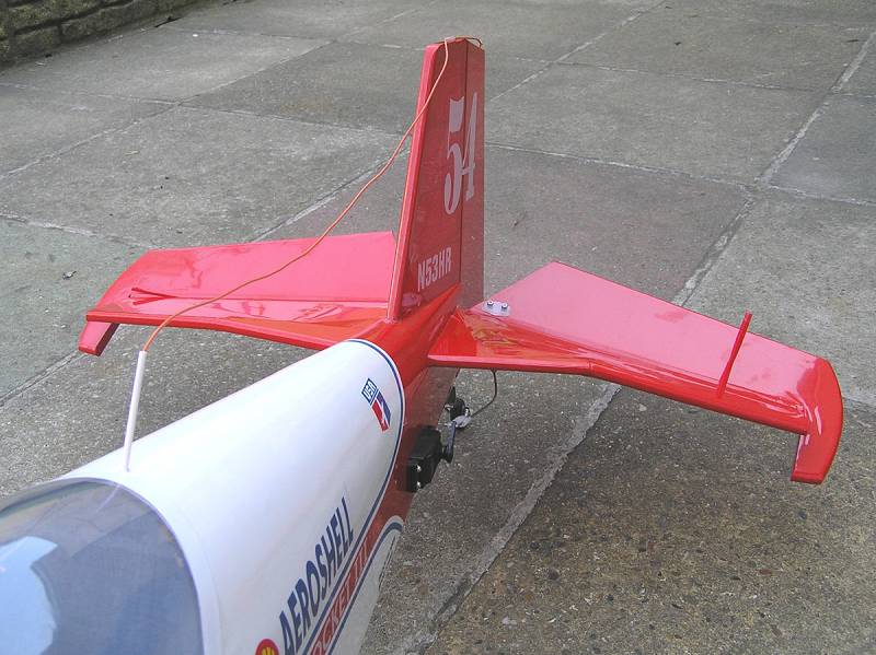

It’s been a bad week for flying. Firstly I put my OMP katana profile in, (pilot error). Then two days later my trusty workhorse Seagull Harmon Rocket suffered terminal tail plane flutter after performing some split S`s and went it very fast with complete lack of elevator control.
The tail plane has snapped in half on either side of the stab. The only thing holding it together is the elevators. Worst of all the battery broke free on contact, striped the wire and shorted out, frying all the electrics. The lesson here being don’t cable tie the battery lead to tidy it up.
The plane only had an Irvine 46 so was not exactly over powered, in fact I was considering a bigger engine for it. I had joined the two elevators together with 3mm rod, running from one s3001. I had used the supplied pushrods which at the time seemed sturdy enough. I had even filmed the hinge gaps as I do with all my models.
This was a fantastic model. It is brilliant value for money at around £90 and easily the best quality of finish and least amount of construction from any ARTF I have ever built. But I know someone else in this thread had exactly the same failure so be warned.
With hind sight I would have strengthened the tail plane, maybe braced it. I would have also used better pushrods and maybe a better servo.
The plane is in remarkably good shape considering the speed at which it hit the ground. I won’t bother repairing it; I might as well just buy another at £90.
I would still recommend this plane to all from novice to experienced pilots. It makes a great windy day bash plane.
BTW the Cof G is spot on with the Irvine 46 up front and only two standard servos in the tail. Battery was on the servo tray.

Sorry about your losses, but I'm sure it'll all soon be forgotten with a #90 outlay and a few hours work. I have also considered bracing the tail feathers, but there's not that much to tie on to back there.

I maidened my son's HR the other day and shortly after takeoff, while flying full-bore, but straight and level, I had one side of the stab fail. Fortunately I was able to bring it in safely.
We added bracing to the tail after it was glued back in place. He also changed to 4-40 pushrods

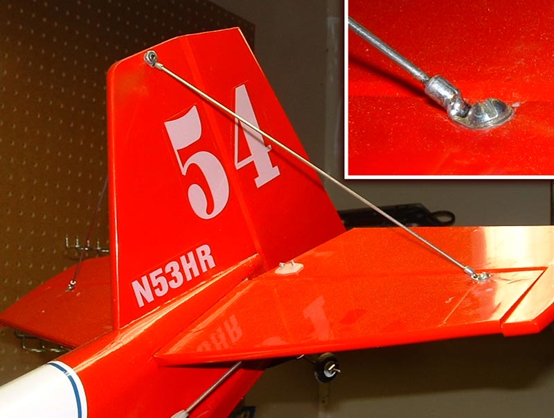

Mikel-T, we rodded the two elevators together, (1/8" Music wire) but if you do that, beef up the pushrod.
Personally, I think the pushrods are too flimsy even if you're using two servos.
And after hearing all of the Stab problems that others have had, (And having one myself) I would recommend bracing the Stab.

how did you brace the stab? will a carbon rod set up like on the funtana .90 work?I like to dive bomb the runway and I'd hate to auger it in wide open

I am just starting to build my new Harmon Rocket. I am VERY concerned about the weak horizontal stab. I am going to install my new Jett 50 in the nose, and I really want to run it FAST... [>:] So I am thinking about removing the covering from the bottom of the stab and adding new balsa structure near the center section in attempt to make it much stronger. I would rather not add and external wires if I can help it. Has anyone attempted this? Any opinions on wether or not this might do the trick? The Rocket looks like a great kit, can't wait to fly it. Thanks to all for your suggestions!

I am flying with an OS .61 FX and a 12x7 prop. I did nothing to strengthen the horizontal stabilizer, and have had no problems in about 20 flights. I like to fly it hard and fast, and the stabilizer is still very firm, with no sign of weakening. I would think if you add some balsa to the bottom of the stabilizer right at the root, or maybe some triangle stock to give you extra surface area to glue to the side of the fuse, this would be good insurance. I would think that the stabilizer bar would be easier.
Minnflyer,
Speaking of the stabilizer bar. What did you use for that. It looks very nice and clean. Did you make yours or is there a prebuilt one you can buy? I wouldn't mind the extra support just in case.
