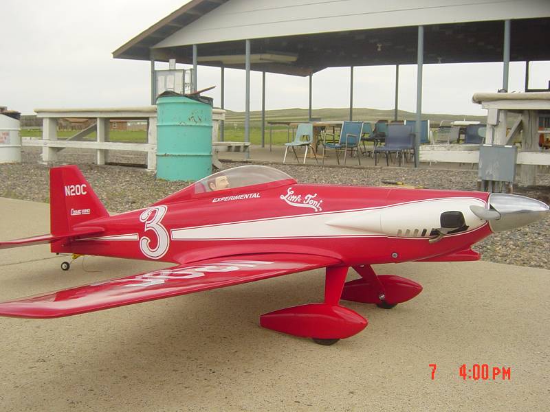

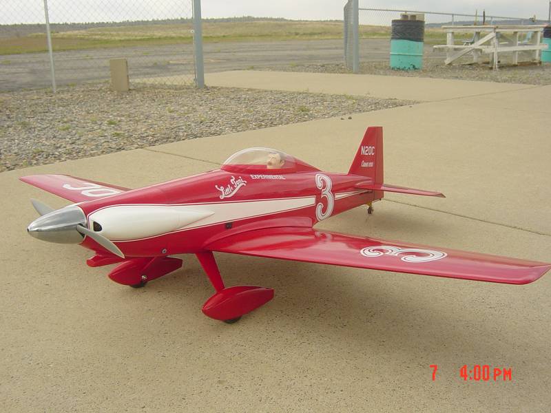

#96
RE: GP Cosmic Wind Minnow
Guys I don't have the minnow but I do have the little toni with a ys-fz110 in the nose. It will turn a 14x11 aps just over 9,500 on the ground. Maybe 10,500 in the air, don't know for sure. But a radar un clocked it at 110 mph flat out, no dive. I have a 13.5x13 to try.
Now I removed all the monokote and reinforced the wing wing 2oz glass overlaped the way the pylon guy do. Then I glassed with .5oz cloth and painted. No ca hinges, and hinges are pined in.
She will move out ad does the bigest loops anyone would need.
