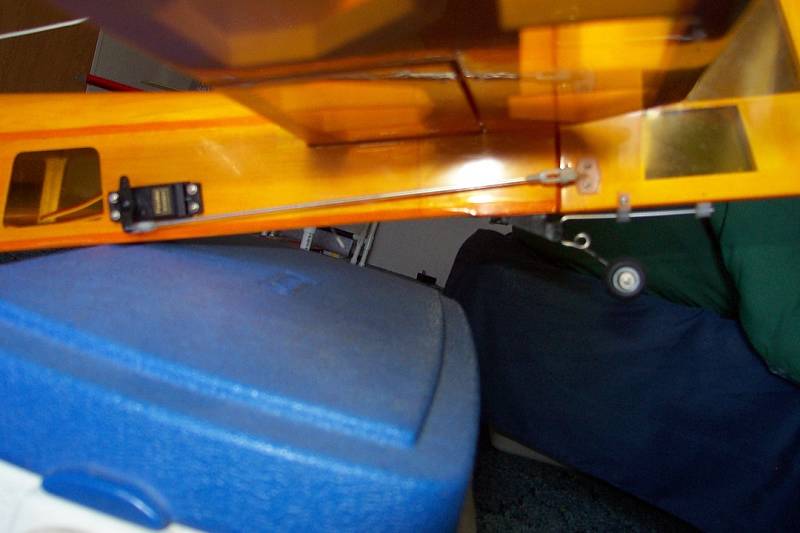

I just got a Phoenix Funstar 3D .40 and I am having some instruction manual problems. The instructions are not that thorough and I am a little confused on some things. First off, They give 4 nylon screws to screw down the wing but only 2 holes are in the wing and it seems to me that the wood that you screw down on on the wing is only balsa and could break through if some stress is put on it. Second, there are 2 extra pieces of balsa wood (4"L x 1" W x 1/8th Thick) which they do not explain anywhere in the manual what to do with along with 4 pieces of triangle cut balsa (3/8" x 1"L). Third, the rudder horn, when mounted, is lower than the fuse not allowing a full pull on the rudder. If the horn is correctly placed (holes lined up with rudder hinge joint) the horn will hit the fuse. Does anyone have any ideas what I am talking about and could offer some assistance... Thanks for your help in advance...

I have built 2 of these planes and love them both..first off this plane is for 3D..DO NOT get it too fast it will flutter the ailerons right off the plane...don't ask me how I know.
First question...the 4 plastic bolts are enclosed to mount the wing of course..you only need 2..the other 2 are spares if one should break..do not tighten these down to much just "snug" them up,under that thin balsa on the wing mount is a piece of hardwood triangle stock that will not break when screwing in the bolts but I just put a few drops of CA on the balsa to harden it,2nd question..I have NO idea what the square pieces of balsa wood they included where for..mine are still in the box,3rd..if the control horn is mounted per instruction the horn will come nowhere near the fuse when deflected..look at mine,one thing though,I can only get about 42mm deflection out of my servo..they call for 50mm each way..I have no problem with the 42mm.
I sure hope this helps!

THANK YOU FOR YOUR HELP!!! It defiantly eases the mind some. I thought maybe I was going crazy or something, like I was missing something in the manual. (P-40LUVR) I did end up installing the rudder horn just as you did, I feel better now that you did the same thing and it works for you. I was previously thinking of using the extra balsa wood where the wing bolts screw down on the wing to add some strength, but I guess I will see what happens when I get to the throttle area, I may use it as (tIANci) did. I did see in the manual not to full throttle the plane as it may break up, that is too weird. This is my first 3D Plane and I am not used to that, used to flying fast and hot doggin', something I have to watch, thanks for the warning. The plane all-in-all looks great and was packaged VERY well in the box. Everything seems pretty sturdy. I can't wait to get it all done and fly, waiting for my O.S. 50SX to come in to install into it. What engine did you guys go with? Any flight characteristics I need to watch for? Again, THANKS!
