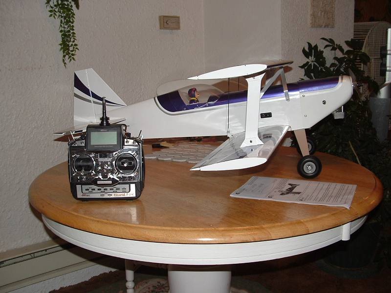

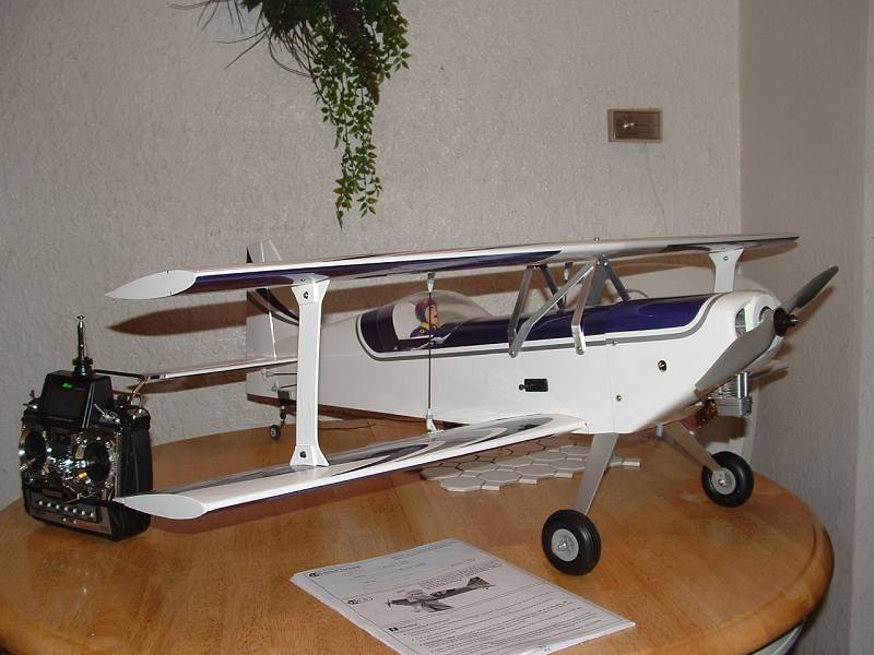

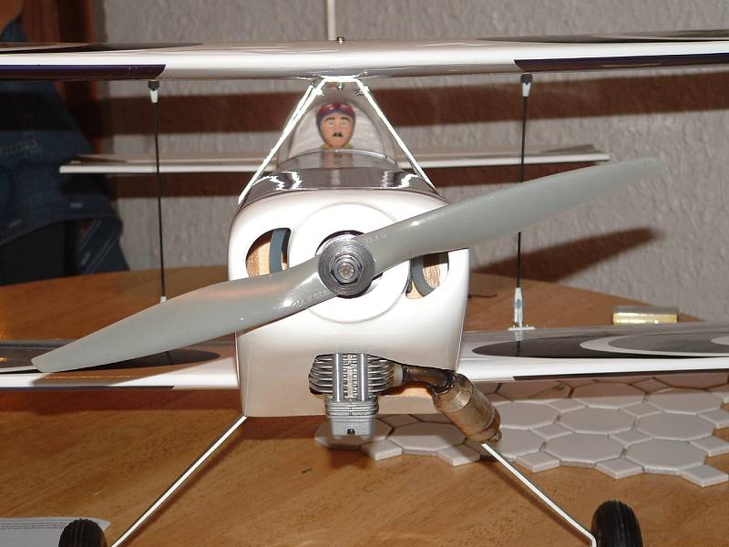

Default RE: World Models Ultimate 40S
Here is my Ultimate ready for its maiden on Saturday. It has a Magnum .80fs for power and all standard servos. It was a good quality kit and the instructions and packing of all the parts bags for all the individual steps was great.
