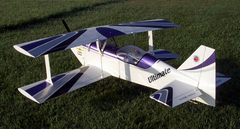

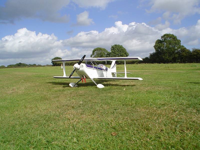

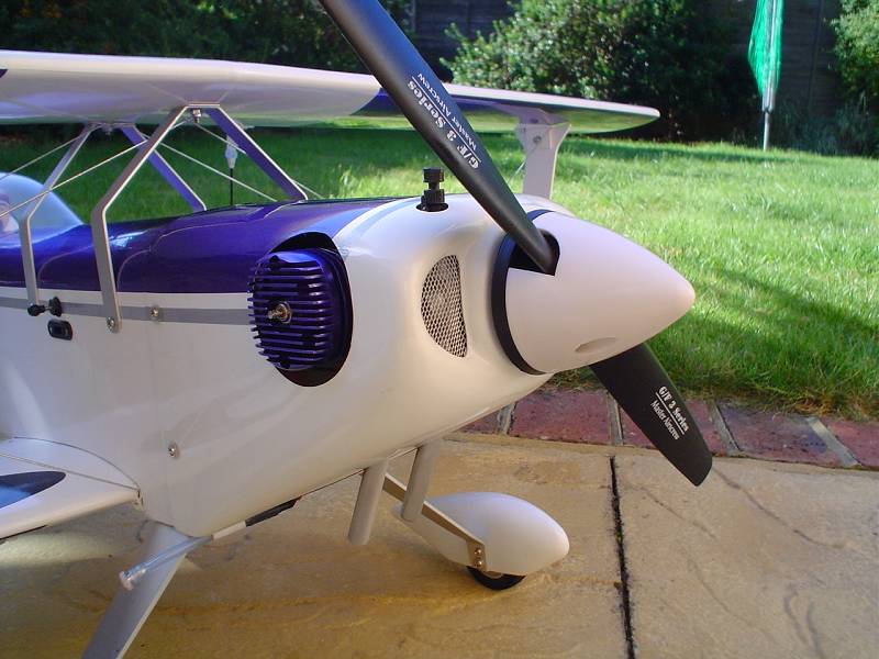

Had the maiden on mine last weekend, flies like a dream!
Haven't attempted anything major yet but from first impressions i think i'm gonna really enjoy carving up the sky with this little bipe.
I have fitted mine with a Just Engines .56 engine (a .56 in a 40 size case!) and first flights were done with a 11x6 prop, but will increase this now the engine is a little more run in!
The engine purple color is exactly the same as the covering, and have used a Bison pitts muffler. Have also added some wing wires for a bit of fun.
Servos standard size except wing where i've used a HS225MG which is a perfect fit and gives a good response.
Wing servos could be mounted out at wings using a knife and a little techinque, but i think that the hs225mg gives more than enough grunt for this plane, no need to overspec.
I put another layer of finishing resin on the firewall and used a bit round inside also just to seal up nicely, but was impressed by the quality of this kit, especially for the price.
All up weight (dry) of mine 4lb 14oz.
Pics below!

J.F
Joined: Apr 2004
Posts: 765
From: Chichester, UNITED KINGDOM
Default RE: World Models Ultimate 40S
ORIGINAL: balsa brain
JF, was the wing incidences right out of the box or did you have to start shimming?
Bill
Tailplane incidence, needed a tiny piece of balsa under the starboard side to lift it a little.
Incidence between upper and lower wing, using provided templates made life real easy, i did need to trim a tiny bit off one the cabane struts to get it perfect.
James

Fuel tubing out the bottom is the filling line, supplied tank gives you option of having 3 connections, so I chose to use all of them.
Yep i used standard setup, even used supplied clevis' ........not something that i'd usually use from an ARF kit, them seem ok, but i'll keep checking them!

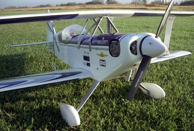

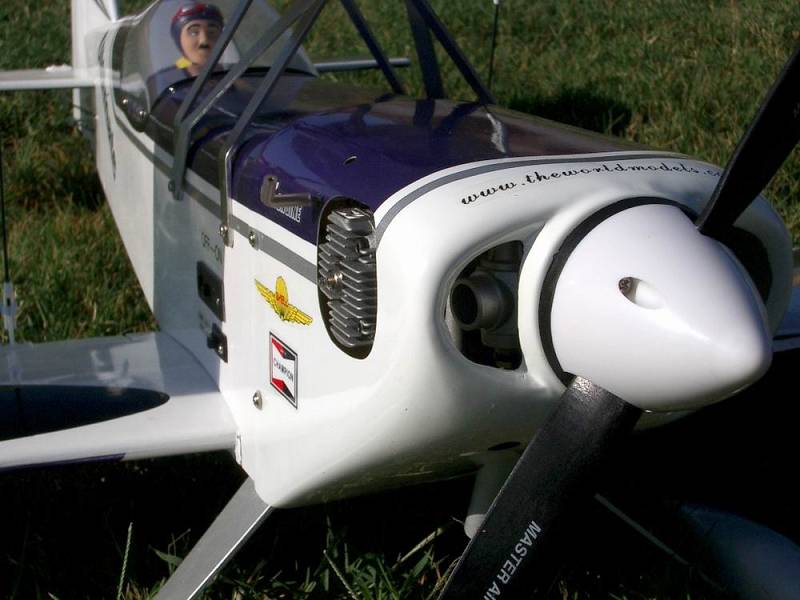

I run an OS 46 AX in my WM Ultimate 40s . Like the last post stated, I placed the battery under the canopy which made the CG perfect with the 46 size engine. I have read several posts where builders are running fairly large engines like the 82 four strokes and I'm a believer in having plenty of power, however, this plane performs great with a 46 two stroke. I selected the OS 46 AX because I've been using one in my Hangar 9 twist for the past year and it has not missed a beat. Its small size fits nicely under the cowl and with a pitts style muffler and an 11 x 6 Master Airscrew prop you have a perfect combination for the weght of this plane.
Out of my performance planes such as the Hangar 9 Extra 260, Twist and Funtana 40, I consider this the most fun in terms of zipping around the sky doing snap rolls and flat spins. It also lands nicely as long as you carry a little speed and even lands well in a dead stick as far as bi-planes go. The only negative is the color scheme as it really blends into sky and it becomes quite difficult to tell which side is up.
