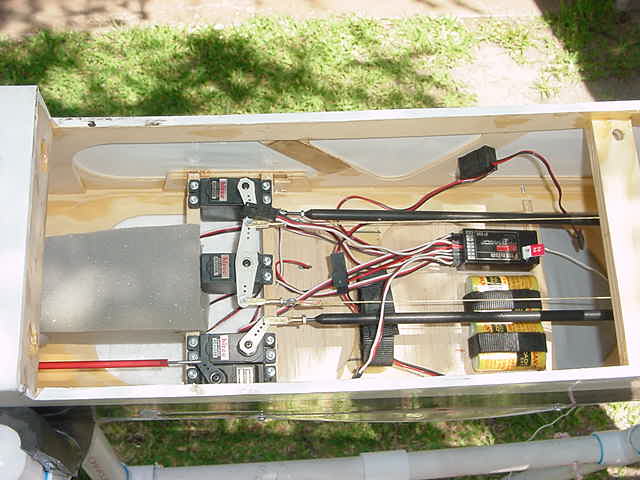

I agreee with Splais... Get those servos out of the tail, and move everything as far forward as you can. I try to do everything I can to avoid making the plane heavier.
Light is right ya know!

Default Here is a pic of my elevator setup...
inside fuselage

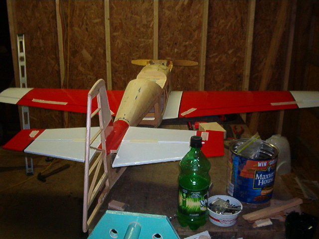

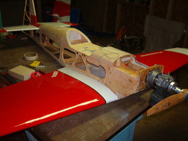

Old 07-29-2007 | 12:40 PM
  #113
KI8FR's Avatar
Joined: Feb 2004
Posts: 976
From: Ovid, MI
Default RE: H9 Cap 232 1/4 scale?
Here is my Cap 232 being resarected. It was in bad shape when I started.. I have a quadra 40cc with 2 rings that has been modefide. It will have Ch ingition on it... I put the servos in the tail. In the pics right now the plane is 8 1/2 lbs.. I think I will be able to keep it at 15 lbs.. I hope.. If all goes right it should be a very nice plane..
Paul
