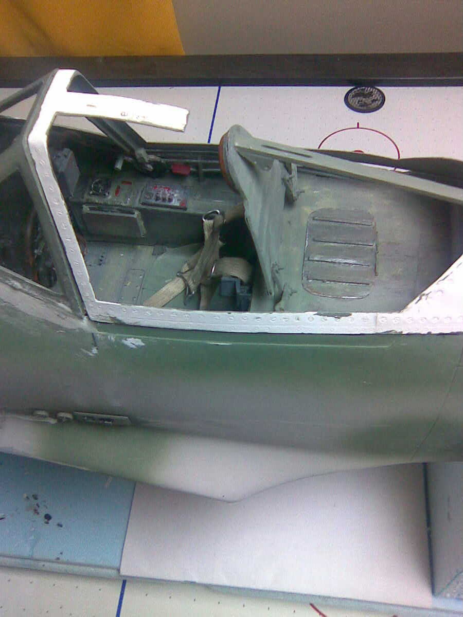

Glacier , I am finishing bashing my CMP Fw190 , while I love to do these arf bashes , in the end , your still left with some serious desing flaws .
My biggest issue is just how bad my tail was off regardless of how well I built a new one .
The fuse was so weak in the tail area that I had to float the tail area , while making sure I was not changeing the incidence . THis was not an easy task and I know if I started with a ESM version , the basic fuse is much stronger and true .
Old 12-25-2009 | 12:34 AM
  #355
LDM
My Feedback: (15)
Joined: May 2003
Posts: 9,326
From: Denver, PA
Default RE: CMP Kits – Problems and Solutions
The wings have now been sealed and waiting for glass , the angles on the wings /tail were way off , mods were needed everywhere .
Canopy slides under air power , sierra retracts all around , G26 ei in the nose
