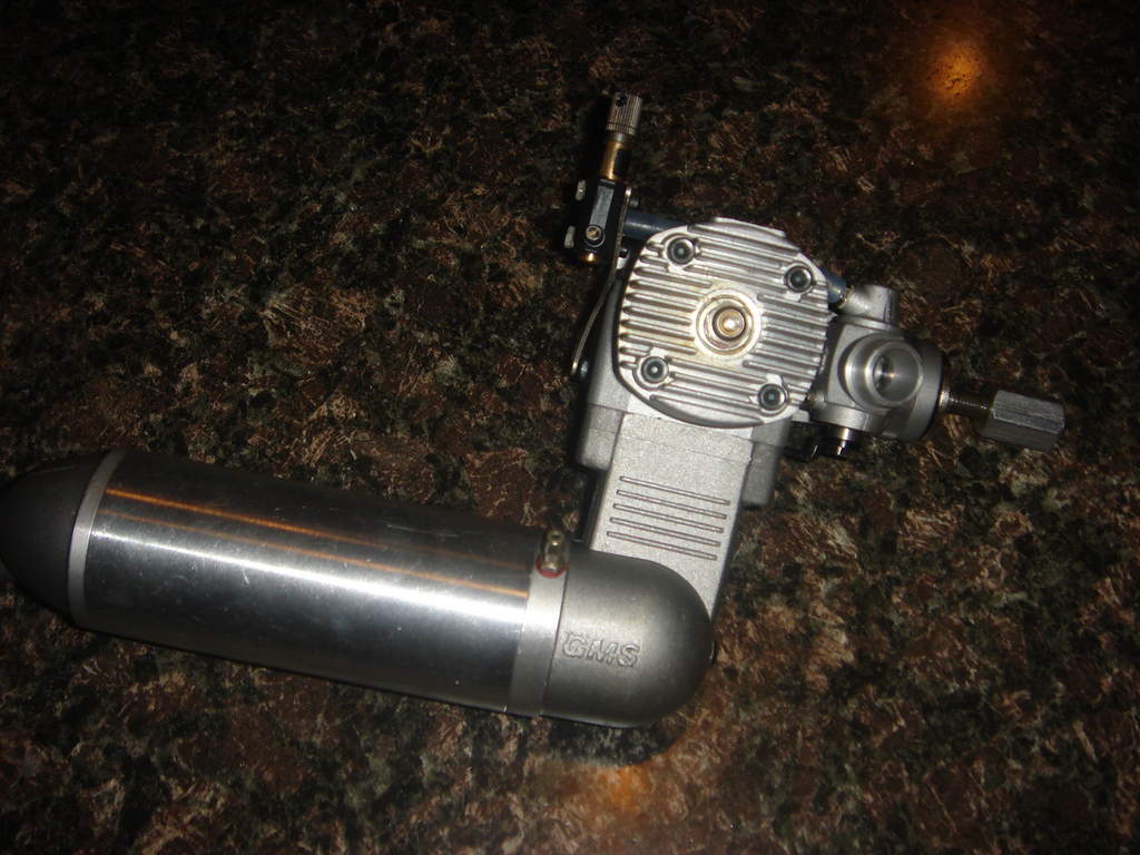

You'll find the SIG engines are notorious for having terrible quality control and carb problems, almost all don't tune worth a....
Maybe your FXi carb will drop into the SIG engine? Remove the stock muffler and try a GMS muffler too for a performance gain.
