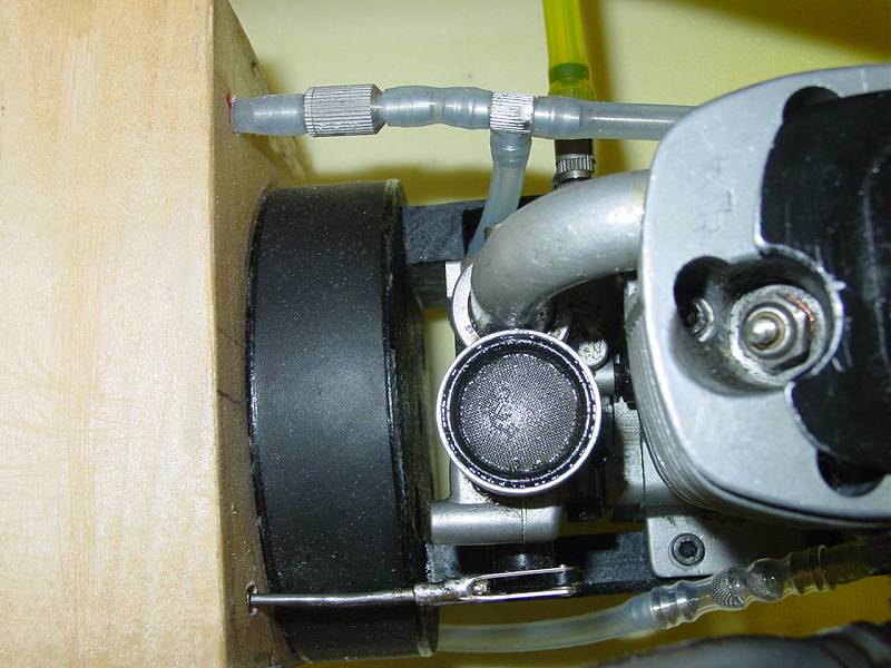

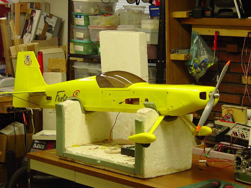

I have seen a bunch this size Funtanas and ,]many different motors on this plane at my local field. I personally ran a YS 1.40L with no problems. The YS 91 guys complained. The Saito guys complained a lot until they put bigger ones on the front, 1.50 I thiink?
The 91 OS was marginal. Your plan to use a 1.20 2-c should work well. If not a YS 110 does the job.
I did retrofit an A type (No nose-ring) hydemount to quieten down the snare-drum effect on the wings.
If you already have motor just stick it on and see what happens. You can easily change it later.
