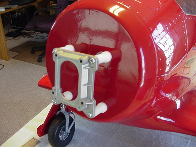

Engine Install:
For the 160 twin you will need spacers to fit the engine to the cowl opening. I used nylon spacers available at the local hardware store. I needed exactly 1 1/4 " for the correct fit. Again for nose weight purposes I mounted the throttle servo on the firewall. I favor this over a long pushrod. I cut and epoxied 1/4 spruce to form an "L" shape, epoxied and screwed the spruce mount into the firewall, brushed on finishing resin to make it fuel proof. Next: on to the on board glow system:
Denis

Sorry photos didn't make it on that last post: here ya go

Old 04-07-2009 | 10:21 AM
  #1125
Joined: Nov 2005
Posts: 18
From: Williamstown, MA
Default RE: Top Flite Staggerwing
Looks great Denis. Are you worried about the throttle servo getting oil in it? I'm assuming you don't have to cut the cowl for the heads. Looks like I may be able to squeeze an OS 3.00 in the nose (cut out for the heads in the cowl I'm sure)
