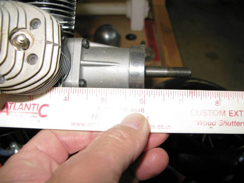

Hey guys, what's your measurement from the firewall to the front of the drive washer? Denis, I see you had to add 1.25 inches with spacers. I believe the length of your engine is 4.75 inches from the back plate to the front of the drive washer. According to the specs on the 3.00 it's 5.83 inches from the firewall to the front of the drive washer. I believe this means it should fit in the cowel. The cowel seems to be about 9.5 inches wide which is exactly the width of the 3.00....hmmm.
I'm anxious to get started on my Staggerwing but have been traveling and haven't had a chance to get going yet...hopefully this weekend.
Tim

The instructions said 6" from firewall to drivewasher, so thats why the 1.25 worth of standoff, trial fit of the cowl appears perfect, but you know how that goes
Denis

6" is a good number.

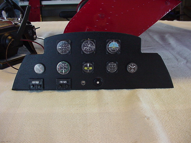

Default RE: Top Flite Staggerwing
Sorry gang I Couldn't hang with the instrument panel sticker< its the scale builder in me I guess. This panel includes the pressure gauge fro the retracts as well as the led for the on board glow.
Denis

Nice instrument panel!
Denis is makin' us all look bad here

I actually have this argument with quite a few. This is a hobby, hobbies are FUN. you do what is fun. If sticking a huge engine on a J-3 cub so it will do 3-D is fun to you thats what you need to do !!!. I just happen to love to build, so doing these little extra thing is where alot of my fun comes from. If you think about it 95% of the folkes will never see that panel. But I have fun
Denis

Denis,
The IP looks good.
If you want to get some really good looking instruments in 1/5th, 1/4 nad 1/3 scale check out InZpan http://www.inzpan.com/ . They are the English site for the ProPagTeam instruments made in the Czech Republic. Probably the best in the market and are already assembled, drill the mounting hole and glue in place. Other brands have you put a clear lens over a decal and the results are not as good. They also have switches, minature screws to "mount" the insturments and other instrument panel and cockpit accessories.

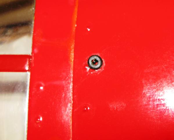

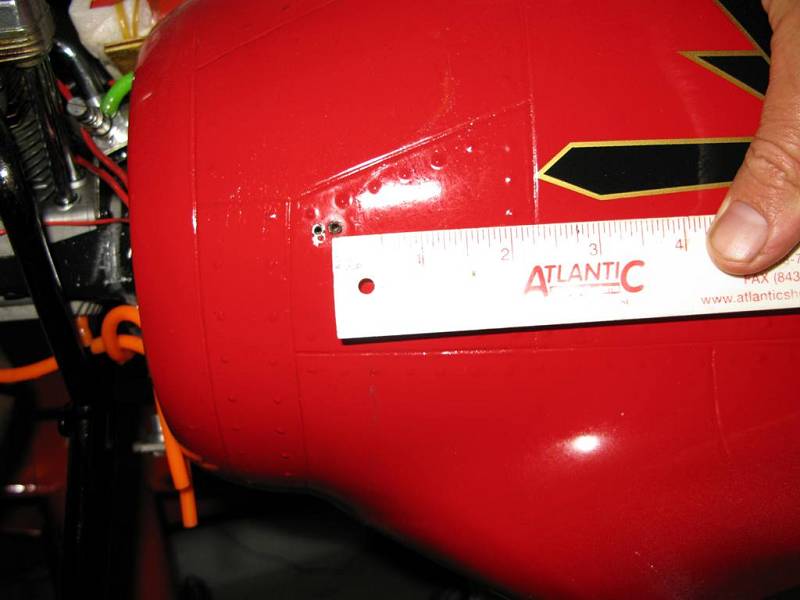

Hey : Paul Wally or whoever is still lurking here !
Just attempted to mount my cowl. First off, instructions say there are "Pre Drilled Holes in the cowl, Nothing on mine.
I also know there are blocks of hardwood fiberglassed inside the fuse where the screws should attach. I have measuered the location of these blocks, and with the cowl on the fuse they come no where near the cowl :: "see attached photos"
Did you guys have any issues here ??
Denis

Hi Denis,
No problems with mine. The blocks were where I needed 'em. There weren't any pre-drilled holes though. Pics attached showing the location of my mounting screws. There are two sets of holes in mine due to the engine change. I'm using the rearward holes (darker colored). Hope this helps.

Hey Denis,
I don't recall... I'll ask Jetmex, but the ply plates are right where they should have been on mine. I do know that. I think the holes were in the cowl, but NOT the fuse...

Paul: Thanks for the photos with the measurements: gawd sometimes I really suck at measuring: Mine was wayyyy off . I used your's and hit right in the middle of the wood blocks
Denis
