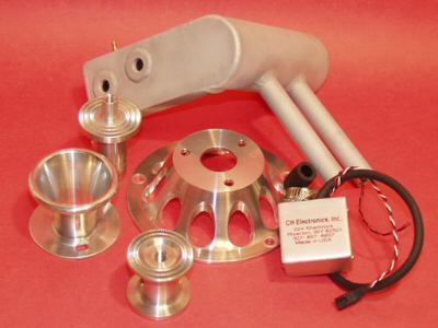

Has anyone got a photo of how a Taurus 52 cc engine mounts to the firewall of the Ultimate bipe? I wonder if just double-ing the exhisting firewall with the engine box tied into new firewall, with a large enough flat area for the Taurus mounting ring to attach to would work? Spacers may have too be used to get prop hub in correct position. Thanks Capt,n

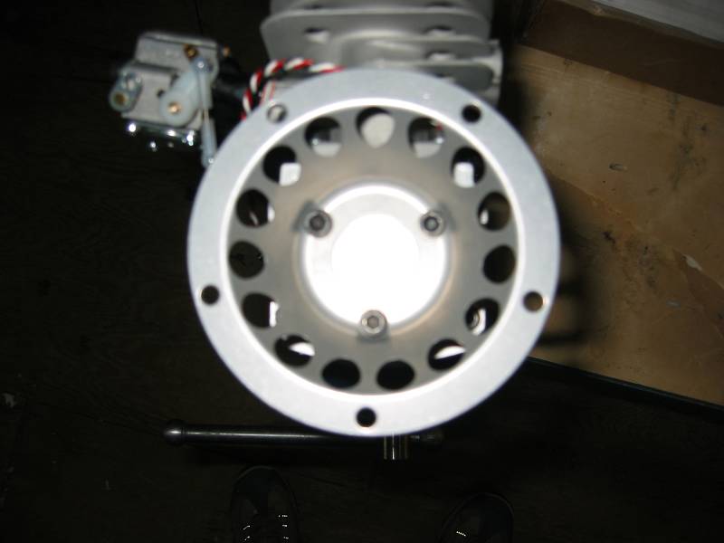

Default RE: Aeroworks 27% Ultimate
ORIGINAL: captinjohn
Has anyone got a photo of how a Taurus 52 mounts to the firewall? Thanks Capt,n
The backplate mount in this pic is fastened onto the engine crankcase. You can see it in the pic I posted clamped in the vise.

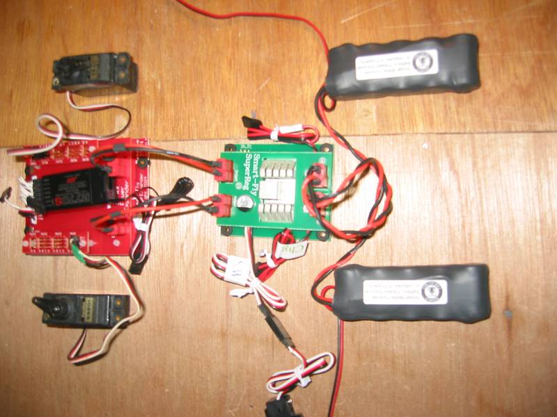

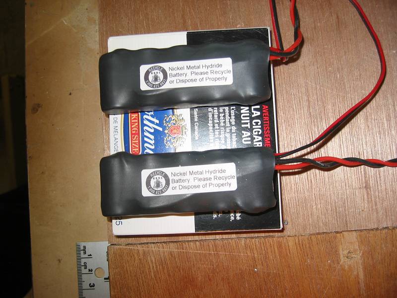

Here's the electric set up for mine. Just finished getting all the pieces. i'm using 2 - 1100 Nimh's for the rec. Hangtime tells me it will be enough for 7 - digitals + 1 - throttle. If not I'll have to break down and buy a field charger, but I wanted to keep the weight down.

What type of flying to you intend doing?? IMAC or 3D?? Personly I would use larger packs. Just keep a close eye on the 1100's if you use them..

I fly only IMAC type ( if I wanted to hover I'd fly helicopters ). I will keep an eye but I presently have a Typhoon pattern ship with 4 digitals + throttle + retracts with an 1100 and fly 6 or 7 flights a day with no hassels. I have a 2700 mah in a 1/5 Mustang 9 servos ( 4 digital ) fly 10 flights ( 2 days ) and still have an hour left on a discharge.

Don M. The useable firewall is 6 3/4 High X 7 3/4 wide. Motor box extenstion is size you want to make it!! Room for radial mount to firewall is one thing. Next having the engine shaft centered with mount not outside of firewall is another thing to think about. Another thing yet ...will the prop hub be in the right place with Radial mount flush with main firewall? Capt,n[] EDIT I found a photo of firewall...so added it here.

OK, here's a pic of the back end of a TS52. The radial mount measures 3 15/16" from outside to outside. Just to make it easy let's say 4" or 2" center of crankshaft to outside. If the "usable" ( I assume you are NOT counting the tri stock ) width of the firewall is 7 3/4" overall or 3 7/8" center to edge than that would give you 1 7/8" to move engine to the left to account for the right thrust.
This seems to be MORE than enough room to accomodate the radial mount. Am I correct ? The height might be another matter altogether, but I have not glued mine so if the mount sits too high I will just make a new firewall, the plywood they supply if I remember correct is not the best anyway.
As an after thought it is 6 1/8" from back plate to front of prop hub.

This is not a Ultimate Bipe...but it is a Taurus engine. The set-up would be simular. I think 4 aluminum stand-offs would be better than wood box.
