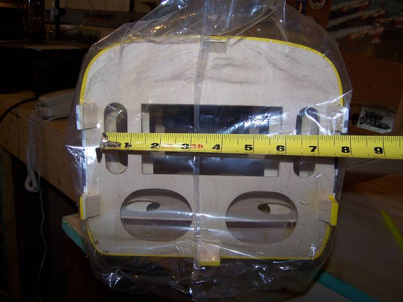

My firewall is 3 3/4inch between the tristock. The tristock on the front is extra stuff that I added and the manual only call for it on the rear side. Hope this helps.

Oh it helps but it's not good news because the Taurus bell mount is 4". I wonder where in the heck Captianjohn got the 7 3/4" measurement [] Anyway I'll work it out with another firewall attached somehow to the original.
Thanks for the help. The internet is a wonderful thing, here I am sitting in the frozen Arctic 600 km ABOVE the Arctic Circle and somebody God knows how far BELOW the Equator is getting some measurements for me. Cool[sm=thumbup.gif]

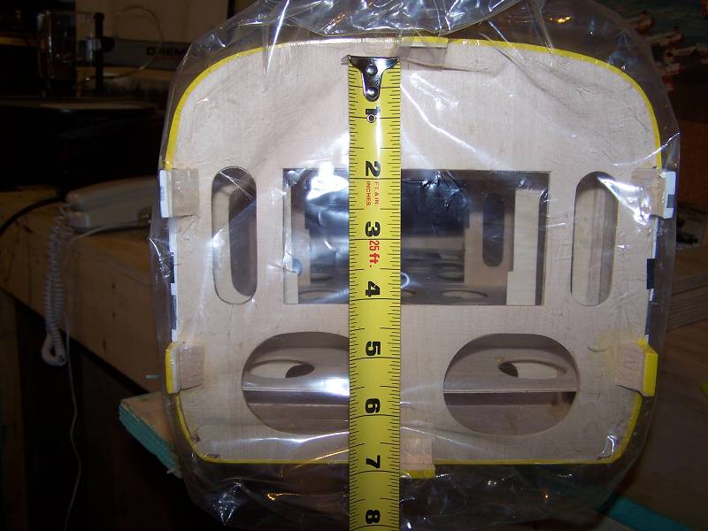

Here is where capt., got the 7 3/4 . Add whatever you think to main firewall (or bulkhead) to make it stronger. Maybe just double it. But be sure and keep the box that ties main firewall to the other 2 bulkheads. Use Stand-off if necessary between mount and main firewall. This is a lot of time doing these photos...hope this helps. Capt.n

Here is where capt., got the 7 3/4 . Add whatever you think to main firewall to make it stronger. Maybe just double it. But be sure and keep the box that ties mainfirewall to the other 2 bulkheads. What do you want? For me to do it for you? Use Stand-off if necessary between mount and main firewall. This is a lot of time dong these photos...hope you appreciate it. Capt.n
Whoa! Don't get nasty now. The picture you put in the original post was of an airplane with the engine box installed, what was I supposed to think but that was the firewall you measured. Seems sensible to me. What your depicting in this post is a bulkhead in my books. In any case I'll handle it from here,
Thank You and have a wonderful day. [sm=spinnyeyes.gif]

Sorry...to much stress today. I would say we are both right. The part you call a bulkhead can also be made into a very nice firewall. I do think you need to tie it in with box extension to the 2 bulkheads inside plane. Do you agree with that? I tried my best to help....just not good at it I guess. Capt,n

The sides of the box go all the way back to the front of the canopy opening. They have tri stock on that former as well as small braces on the box sides that tie it to the formers inside the fuse. I guess if you use a larger firewall you could tie it back to the front former wit some thin ply and tristock but its not really needed.
Also if you need 4 inches to mount your engine, cut the box sides off flush and you should have 4 inches. I overlapped my sides and added the tristock for added strength. just a thought..
