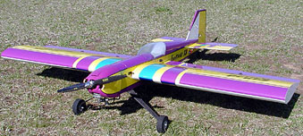

Well -- I just weighed my YS 1.20 NC powered FW3D and it's 10.0 lbs. Of course it still needs a muffler, switch, battery, cowling and rudder servo and push rod... I guess I'll be in the 10.5 lb range when complete.
I checked the CG and it's very nose heavy. I put it on the CG machine and hung the uncut cowling from the engine and put the HS645MG servo on the stab and it was still a little nose heavy. I guess my Sullivan tail wires are a lot lighter than the push rod setup it came with... I am hoping that a tail mounted rudder servo, and a battery a few inches behind the wing tube where the pull-pull rudder servo rails are will get the CG about right.
Has any one else tail mounted their rudder servo? There really isn't much room back there given the narrowness of the fuselage and the existing elevator servos. I am thinking of mounting it through the bottom of the fuselage right on top of the rearmost elevator servo. I need to mount it about a 1/4" proud of the bottom of the fuselage to clear the existing elevator servo. This should help the geometry of the push rod clear the tail wires too. Any thoughts or suggestions would be greatly appreciated?

That just may be the solution. I means opening up the tail -- again, but putting the servo inside as far back as it will go with an arm sticking out on one side should do the trick nicely. I don't think I'll go with two push rods as in the picture. A 4" 4-40 rod is pretty stiff... I could do a short pull-pull as I have some cable left over from the tail braces and some exta long Dubro super strength arms...
Also, I have a left over servo tray. I just found in the manual that it is supposed to go around one of the elevator servos -- the one that is not recessed into the fuselage a little. It doesn't appear that this is necessary and I already have the servo and linkages mounted. I don't want to push the servo out and mess up the linkage alignment. Did anyone else not use this piece?

The GSP method of tail mounting the rudder servo isn't going to work. There simply isn't enough room. I guess I'll be putting a couple of oz of lead there instead...
I guess everyone else used that little servo tray when mounting the non-recessed elevator servo...
FYI -- I just saw the World Models ad for the new version of the FW3D in MAN. They have really changed the tail with larger control sufaces and removed the tail bracing... :angry:

In the process of learning to see if the GSP method of mounting the rudder servo would work I discovered the solution to the extra servo tray. Glue it to the inside of the fuselage! Problem solved...
I guess my pull-pull geometry isn't quite right. The non-pulling side goes slack about half way through the rudder's travel...
Well -- mine is almost done. I need to finish the programming and set the CG. The box of little bits in now empty!
#240
My Feedback: (18)
I just weighed mine -- 10.8 lbs...
The good news is that not tail mounting the rudder servo was a good thing. The CG is spot on with the rudder servo mounted in the stock location!
I put a 5 cell 1100 mah NiCd under the rudder servo and that must have made the difference...
Did anyone else have trouble getting their wings flat against the fuselage? Maybe my wing tube is too long...
