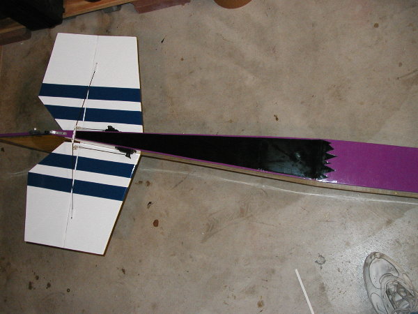

Mine is real close to being ready to fly. I'm going with a TT1.2 two stroke. I have an OS 1.6 in reserve if it doesn't perform. I'll be ready to fly in the next week or so, if the weather cooperates. Has anyone made any modifications or changes? I questioned the aft section of the fuselage being all balsa, it seem like a weak point. I uncovered the bottom of the rear open frame work and glued all the joints, then covered it back up. While it was open I put my servos in along with the extensions for my cables.If feels stiffer to me now. Pete

I found one of the balsa diagonals that was loose. As it felt around the fuse I just thought I would benefit gluing everything. Cutting the covering off of the bottom open frame work allowed me to get to all of it. It makes me feel better knowing that everything is secure. Also, just for information, my weight is 9 pounds ready to fly. Pete

How did you cut open the covering on the bottom. I don't want to lose any of this stuff as it is an odd color. Did you cut on the black tape around the side of the fuse? Do you have a pic?

I cut on the bottom side just inside of the lower longerons. When I was finished I covered it with a piece of black monokote and stopped it where the balsa sheeting starts at the wing trailing edge. I used a "saw tooth" at the trailing edge location so it would look like it was broken out, looks sort of cool. I'll try to get a picture on tomorrow. Pete

Here is a picture of how I covered the bottom of my plane, nothing fancy but it looks fine for me. If it wasn't on the bottom I would have had a better idea, but not many people will see it except when I hover. And then they will be so impressed with my flying skills that they won't even notice the covering! Ha!
pceagon,
the rudder cables come out on top of the fuse just in front of the vertical fin. I drilled a hole in the balsa block by the fin and took a rat tail file and made it a long tapered slot. The cable cleared the rear bulk head and had to pass over the first balsa stick at the base of the fin and went under the rest of the other sticks, straight to my servo. I hope that makes sense. Pete
