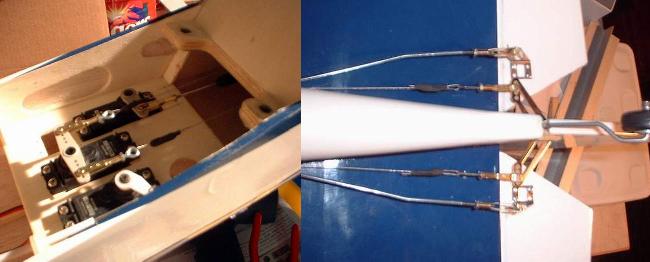

Default linkage
Got the linkage hooked up today -
