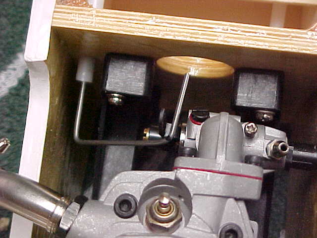

I'm putting together a LT 40 with a Magnum 52 four stroke. I am trying to figure out the best way to run the throttle linkage. With the throttle arm behind the cylinder, there's no way to bend a push rod to connect to the arm. I know there is a bell crank system that you can connect to the engine mount and go thru the firewall and then back to the throttle arm. Does anyone have some pics of a set-up like that? or an alternate method of routing the linkage?

Sure there's a way. you will need one of the ez connectorson the carb throttle arm. set this up without the servo connected at first. put the pushrod in the fuse bend a ninety degree angle when it comes out the front. line it up with the ez connector on the throttle arm. Now here's the important part. moving the pushrod from inside the fuselage work the throttle from full closed to full open. make sure the complete travel is smooth and the carb really closes all the way as long as opens all the way. you may or may not have to change the angle a little bit but it is possible. then when that is all right hook it up with another ez connector at the servo arm. use the ez connector at the sevo arm for the final travel adjustments. Don't forget some blue loctite on the ez connector screws.

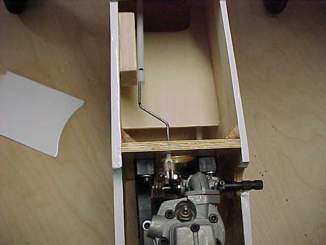

Here's a couple of pics, as you can see the throttle arm is really close to the firewall. You're saying pushrod thru the firewall then a 90 degree turn to the arm. I'll have to make one more 90 at the arm to connect it right?

here's a test fit, not connected yet but it looks like it'll work, I'm not crazy about using ez connectors but like you said I'll use plenty of lock-tite
I hope this helps someone else with this set-up.
Thanks for your help, Bodary

Yes that will work. hard to tell from the picture it looks like you may have been better off. either redrilling the hole for the throttle pushrod to get closer to the throttle arm. or maybe turning the carb 180 degrees and then redrilling the pushrod hole. Like i said hard to tell right from the picture. if you've already modified the fuse sides to clear the needle valve and the exhaust. you're going to have to live with it otherwise i think you'll be better off turning the carb 180 degrees.

Back to the drawing board, it's got too much slop in it. Turning the carb 180 won't work without making major changes in servo location, due to tank location and nose gear pushrod location.
Theres got to be a better way. Surely someone has a 4 stroke in a LT 40.
On the Rascal I had to put a horseshoe bend in the pushrod coming out of the firewall, I wanted to avoid doing that on this one.

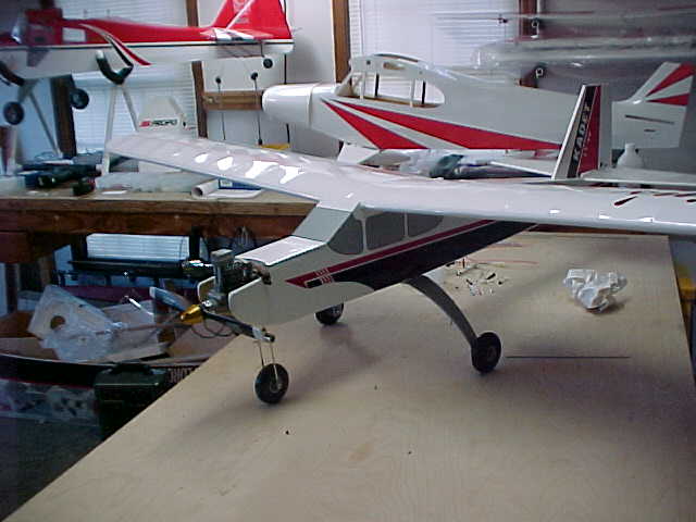

How about just running a new throttle pushrod in the center of the fuse. That's what I did on H9 Twist was really easy to do.

That might be a possibility if I can get it around the fuel tank

Well here it is, I followed Jlank's advise and ran the pushrod down the center it works great.
Happy Birthday Kevin!!
