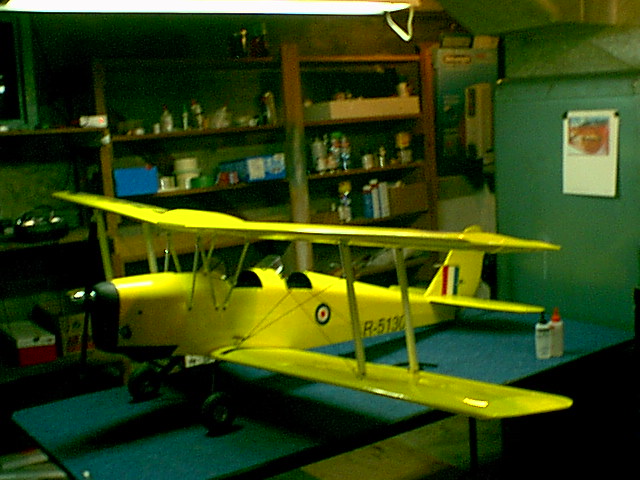

OK, here we go. I work on my planes when I am in the mood, so I am not a lightning fast builder. but I do this I can add things that would help others.
Page 1 of the instructions has you glue these 4 BALSA blocks to the wing servo access panels, then mount the servos to them. Personally, I am not comfortable with that idea, so I am going to substitue them with similar sized rock maple found at the LHS. I will even reinforce these with 1/4" tri stock.
I have found a full size Moth online for sale. It is blue and yellow; of course our Moth is all yellow. I have some Plasticote spray paint in that shade of blue. I have tested it for adherence to our covering and it seems good. Will be testing it for fuel proofing, even though with the inverted four stroke fuelproofing shouldn't be that much of an issue.
In putting the main wheels on the avles, I found the wheel collars to be too soft, so I got a pair of DuBro 3/16". Even at that size, I had to use a drill to make the collars fit over the axles.
I intend to use as much as the supplied hardware as I am comfortable with.
As a previous post mentioned, the tail appears to be meant to stay on the aircraft with 2 small screws, coming up through the bottom of the fuselage and into blind nuts inside the vertical stabilizer. I, too, am not comfy with that and will be gluing them in place.
Yes, and givem CG would have been nice. Hopefully we can share information and come up with a range on out own.
I am not super clear on the upper wing mounting. Perhaps others can enlighten me?

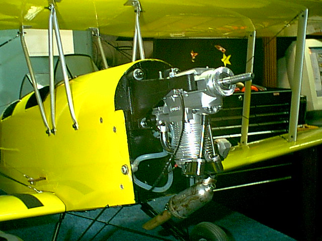

Snow was in the forcast, so got some time to play with the Moth. Mounted The YS 120 to the firewall, built up the fuel tank. Started to put the wings on with the struts. I change the Metric hardware to 4-40 1/2" long and locking nut. Using the Pacific Manual and figuring out how to adapt the Nitroplanes to that manual. First thing was look at was flying wires. Need to go to Wally Word to pick up some Lure swivels. Would have sworn I had some in the tackel box! But aint fished since I took up this hobby. I had some 2-56 thead solder ends and drilled a hole in them to fit the wire. Looks like the picture. With the YS up front the Balance seemed tail heavy.The plane dose have a long tail moment. I haven't put the servos or radio gear in the fuse yet. Looks like that stuff needs to go forward. (I dont think the servos will be going in the tail.) The tiller bar out the side is scale, so I'll make the wires for the rudder come off the side of the fuse to move the rudder back and forth. Than make a tiller bar for pull-pull elevators in the fuse and will see how that goes. I guess this gonna be a Pacific-Nitroplane! Things to get still on board glow driver. Header pipe for the YS.

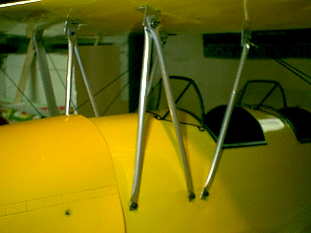

I am now trying to mount the top wing. The lower wing fits without any problem. The cabane struts and wing struts do not fit on my plane;i am having to JB weld the holes in the wood and redrill. Will be setting the incidences up for 0 degrees to each other. Has anyone else had this challenge?
The way I understand the way these are supposed to work, the struts fit over the wood attachment points and are held in place by screws. The holes are not lining up, even when the cabane struts are carefully measured.
This is not a huge deal, but just a small challenge.

Top wing was a custom fit. Played with the struts till the holes were close and used 4/40 socket screws with locking nuts. Doing the rigging myself now. Really not sure how I'll set up the rudder and elevator yet. I don't see doing much on till the weekend.

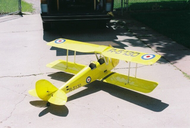

Just finished building the Nitro Tiger Moth. After thinking a bit and studing the Pacific Aeromodel Tiger Moth instructions, it became clear how it went togher. Required no mods or parts. I did deside to mod the wing wires, however. I used small springs at one end to keep tight, works well. I am using an RCV 120 for power. Will fly soon.
Also, the CG location is now illustrated on the Nitro Web site.

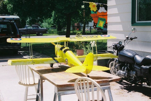

How did you guys set up the flying wires to get the wings to stay on.I have tried a couple ways but cant seem to get them right.Thanks
Joined: Oct 2005
Posts: 45
From: Polson,
MT

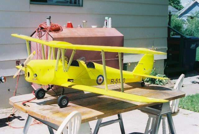

I first flew my Tiger Moth with out flying wires and just added them later for looks. The design of this model is strong enough to fly with out wires. They send you all the hardware you need to set up the wires. I have taken a whole differant approach. I was not sure how my radio would react with all that steel cable webed between the wings so I went down to walmart and got some 1/8 inch 50 or 60 lbs black nylon cord to use for the wires. I installed the nylon cord to the mounted secureing tabs included in the kit with small fishing swivel hooks. I cut the swivel part from the hooks and threaded the nylon cord through the hole then tied a single knot secureing it with CA glue. I did it this way so that I can easly remove the wires when I take the wings off. It seems to work out with no hassels.
My Camera is down for the moment, If want I'll post some pics if you think that will help. It would be no problem to post pics once I unload the pics already have on it.
