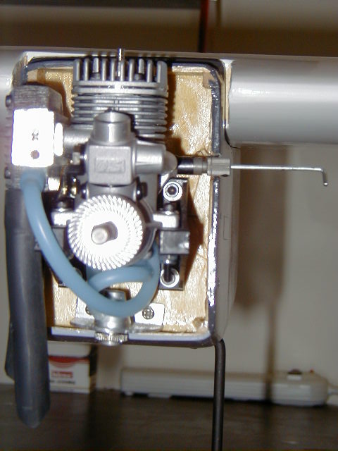

Do you have pics of your motor installs?

Bill Yonescu: My ARF is due in today......so I am still blind about the whole motor/space issue....
Do you have and digital close-ups of your install? I like working with small companioned like HobbyHangar, but usually they tend to communicate better than this....

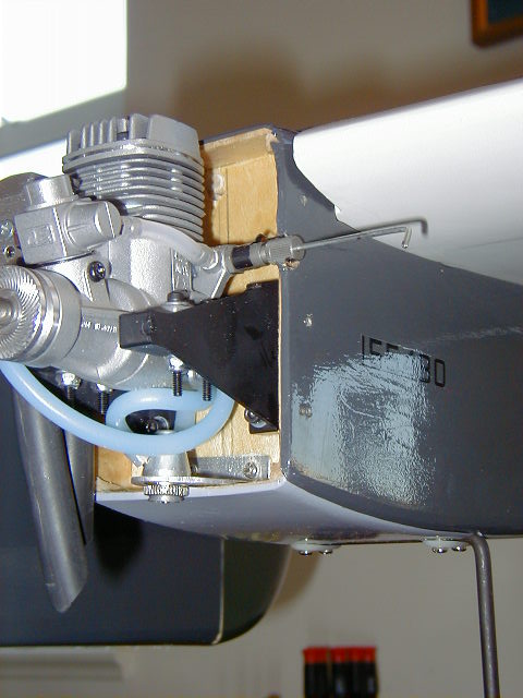

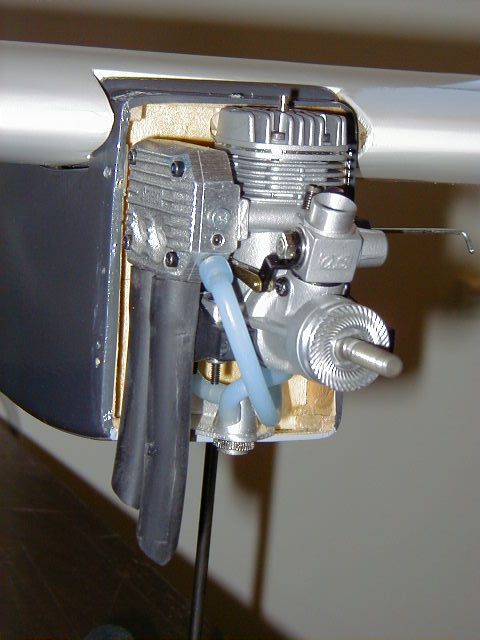

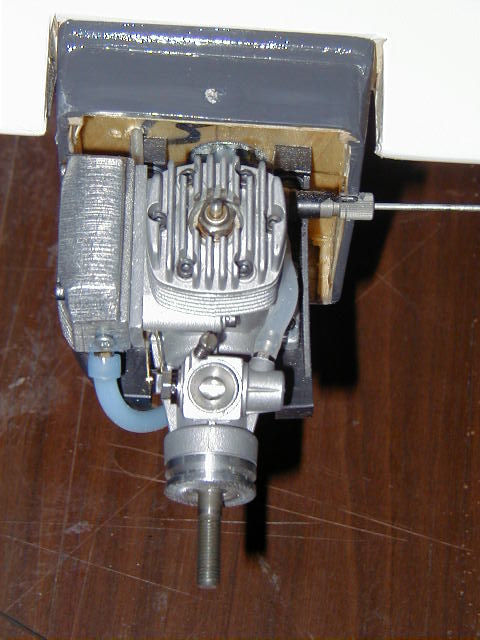

Here is photo 1
Note the misalignment between the spinner and the cowl. I mounted the engine mount 3/4' above the bottom where instructed to do so. The cowl won't move down any further without hitting the engine and not being at all centered in the hole. I think mounting the engine mount 1/4" lower would have made the cowl fit better but not sure what that may do to the flight characteristics.
