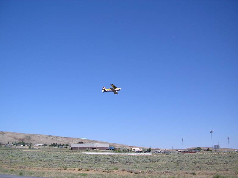

I've built and flown the Nitro Ultimate 46 with a 52 Magnum on it. Way more engine than the plane needed. A quick backoff of throttle was needed.
Mine was missing most of the screws needed to complete the build and had a bunch of extra screws that didn't go anywhere. The battery is under the pilot seat. I added 1 3/4 ounces of lead to the tail and 3/4 ounce to the right wingtip. I have a World Models Ultimate 46 and used the template from it for the incidence. The worst part was the covering. It took an hour of ironing to get it on tight. The next worst part was the instructions. They are just a partial copy of the World Models instructions.
Guys that have flown the Nitro Planes should do some reviews in the User Reviews. Here's mine!
http://www.rcuniverse.com/product_gu...fm?kit_id=4407
Heres My Plane.

I flew the Nitro Models Ultimate tonight for the second flight. The wind was 10+ mph. 50 yards from the runway I saw something flittering to the ground. The plane was still flying well so I brought it around for a lookover. The right wheel and pant was missing. I flew around for a couple more minutes waiting for the wind to die off a little and to burn off some fuel weight. When the time was right I landed. The plane did well on landing but I slid it off into the dirt and it flipped over on it's top. I walked over and found no damage. The amazing part was I went looking for the wheel and pant. I found them after only a minute search in the thick sagebrush. Both were still together with the bolt and retainer. So far I haven't really had a good long flight to where I can really play around in the air. I did notice that the Magnum 52 with a 12.25x3.75 prop pulls this plane around with authority. Tonight on a landing pass I was coming down a bit fast. I gave the throttle just a couple clicks and it was more than enough to get the plane back into the air for another pass.
Here's another photo after tonights landing.
