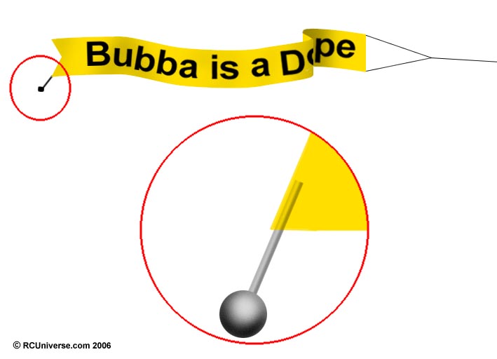

You can use any light-weight fabric, or even a piece of netting with letters attached.
What's more important is how it is set up. You need to add a weight to the bottom of the TE so that it doesn't twist and turn. It's also a good idea to have a release, so in case you get in trouble you can detach it.

Minnflyer: Have you actually tested this and know for a fact that the illustrated weight works?
I can't get my head around how that weight wont drag the whole "sign" down or prevent it from spinning...hmm..

Hmm....usually the weight is at the front of the banner. You have a rod at the front to support the leading edge, and a weight at its bottom.
With the weight as shown in the diagram, there's nothing to prevent the leading edge of the banner from spinning 'round and 'round.

Ooops, Bax made a good point that I forgot to mention...
The LE of the banner must be stiff
As far as the weight, I used one in the rear, but one in the front would work too. Try it either way (Or both) and see which works better for you.

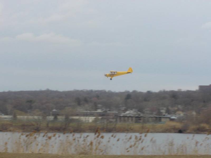

Okay Just so I can get a clear understanding I have provided a picture of my cub flying. Someone with basic editing skill can please show me where I would attach the towing cables based on this picture. I'm not exactly sure where I would attach it.

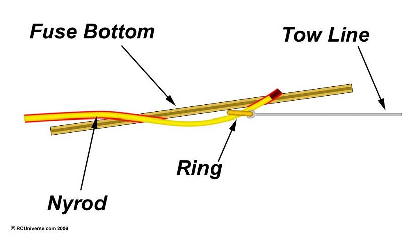

NJAIRSTRIKE, It's not critical where you put it. The closer to the tail, the more it will affect your pitch (You need to add down trim to hold the tail up) The closer to the wheels the less it will affect your pitch.
BTW, here's an easy release mechanism.
