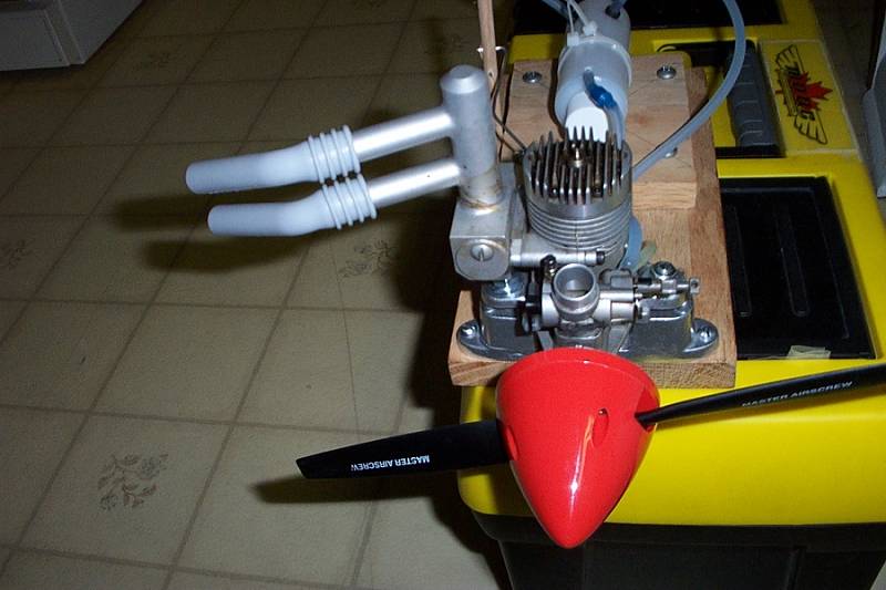

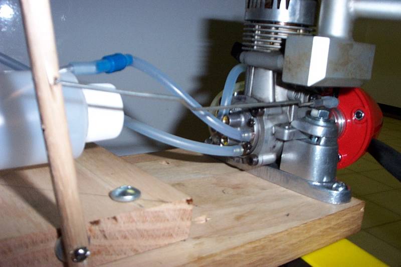

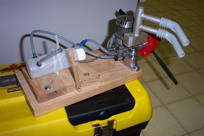

ORIGINAL: roltech
That's good! tried to figure out how to turn the rain around your way! too complicated, so I won't have to now.
I am now building a test stand with tank throttle control etc, so I can set it on (motor) and can get at all the lines and needles settings, just about finish would of been but the battery powered drill lost power drilling this solid oak stock used for the engine stand, can't win I've been using this drill for a while I guess it needs a rest, and why not! we had nice weather in the last couple of days and have been flying. but I promise I will get at it when more free time is available.
roltech
Stickbuilder.
Finaly I finish the test stand and took the motor out and installed it on the stand, however still did not get a chance to try it, that's the next step, I have removed the tank out again and took it all apart, I may have to replace it now because I damaged the interior stopper trying to take it out! no big deal! I found out it was a 12 oz tank though, anyway here is some pictures take from the motor out and on the test stand, some pics are a bit blurred camera can't take good close up.
Thanks for your help.
