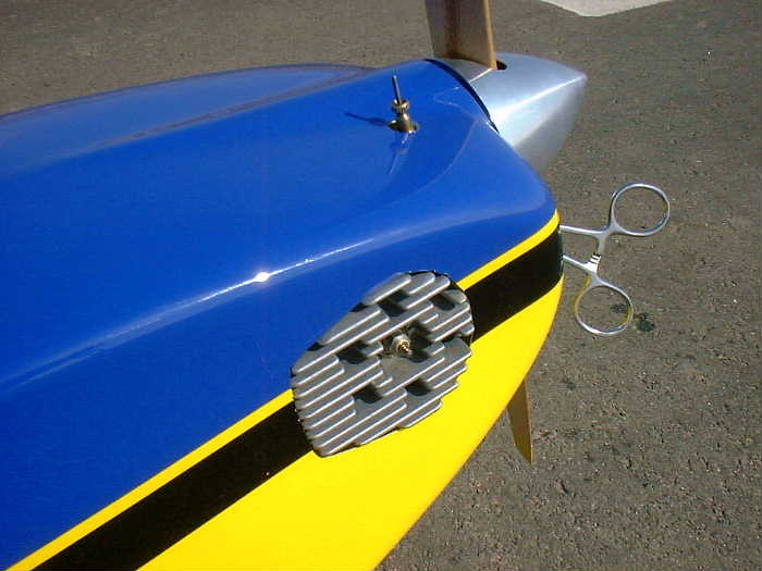

Another shameless plug. The engine head is almost flush with the cowl. This is a bad angle but it looks quite neat up close and personal.
Mike

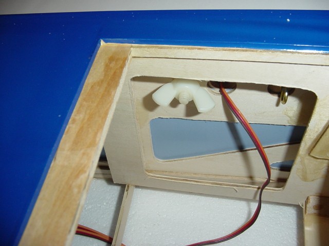

had a spare moment to do some work on the extra

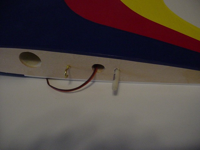

changing the wing style

the cottor pin will keep all in tack

exopy or pro bond the stud into the foam hardware can be obtained at lowes or home depot

now u have both methods still in place and very little weight added but a very good piece of mind for those hard snaps and such.....

Well, you're not so "Krazy" after all. That's a fine idea. I may just copy that.
Thanks for the pics!

i rather u copy that idea and keep the plane around longer u feel me? that is what this site is all about sharing ideas..... the 2 pieces idea will work that way if one part of the fuse breaks something should still be holding that wing tube u know?
