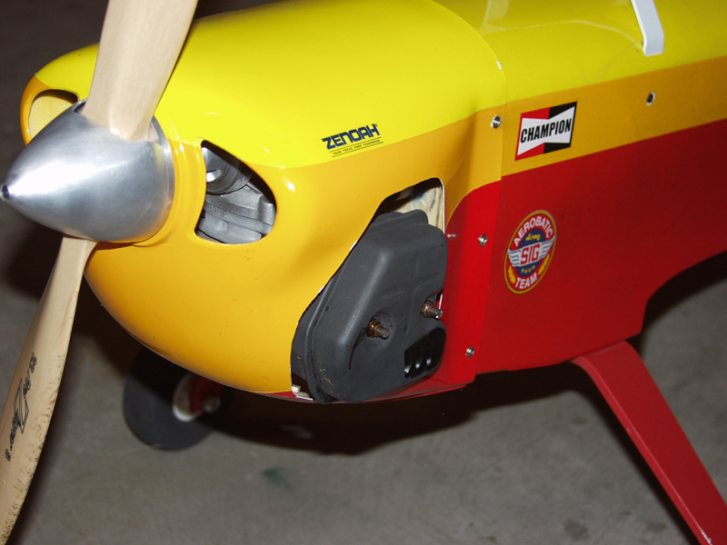

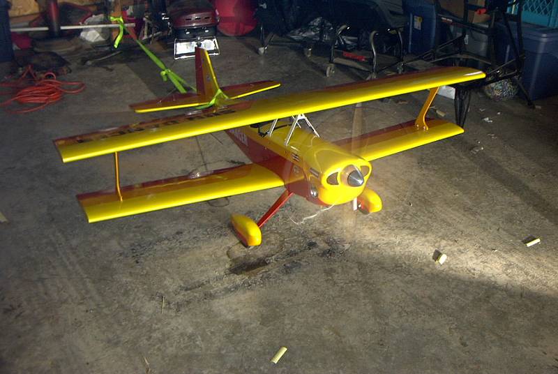

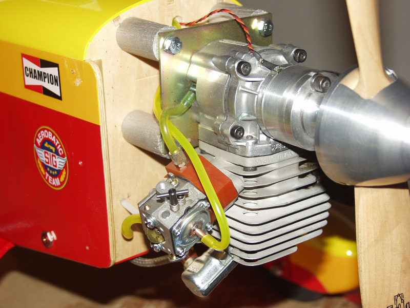

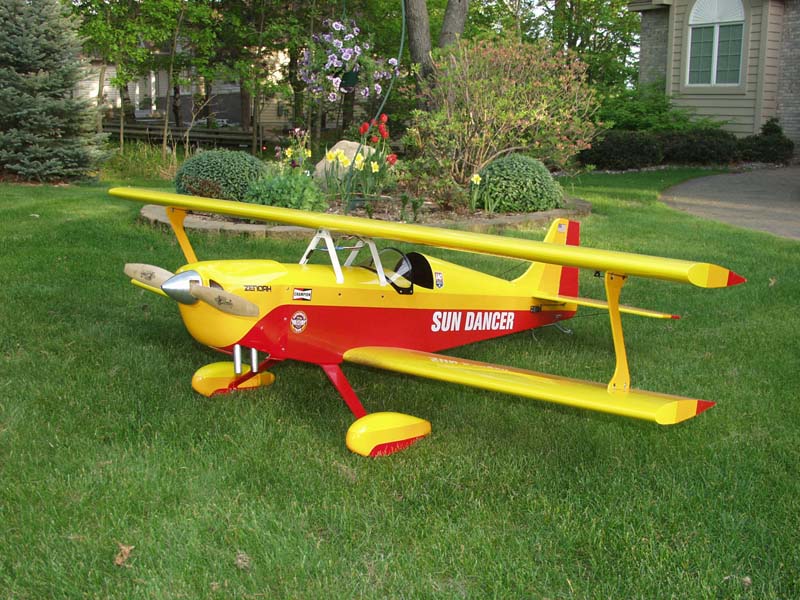

Congratulations on the deadstick recovery. I've done them many times, but on new aircraft it is always traumatic. I am considering this model and looking at the G62 for power. However, I hate having to butcher cowls to squeeze in the powerplants. I can't bring myself to spend that much money for a FPE or Desert aircraft engines, but the G62 doesn't appear unreasonable in price. What mods did you have to make to the cowl, if any, to fit a G62 in and what did you have to do to balace the aircraft? If you wouldn't mind, please.
Goofy
Old 04-27-2006 | 03:50 PM
My Feedback: (17)
Posts: 1,427
From: Goodyear, AZ
Default RE: my new sig sundancer
goofy,
I originally had a G45 on the plane, but put the G62 in it this spring. The cowl with the G62 is a little ugly because I just modified the cowl from the G45 so the holes are a lot bigger. I will be replacing it shortly. The picture of the plane outside shows the G45 with a loud muffler that was replaced with the stock Zenoah muffler, but the picture will give you the idea. The picture with the cowl off is the G45 installation.
I picked the G62 off Ebay and had electronic ignition added to it by RCIGN1. Runs great. There is a 6v receiver battery in the tail with 3/4oz of weight, and flies with very little down elevator inverted. The battery location is the only thing I did to accomodate the engine.
I hope this helps.

Well, the pictures finally came through. Regarding the G62, there is a dealer selling new ones for $265, without an expensive prop hub. RCIGN1 converted mine to EI for $175 and his cost includes his prop hub. The engine lost 11oz, and I think he has found ways to make them even lighter.
