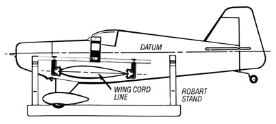

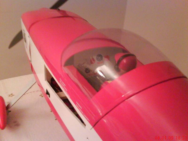

I know that you're going for the Edge V2, but still could you post some pictures of your V1 here. I'm curious about your wing incidence.
I've noticed that the ones with negative wing incidence have a grey instruments panel, instead of a black instrument panel.
I would really like to know how it lands with both configurations... Anyone?

Here's some more detailed pictures of both airplanes
On the right you have the black instument panel (good wing incidence), see the longer back "leg" for the screw.
Ont the left you have the grey instrument panel (negative wing incidence), see the shorter back "leg" for the screw.

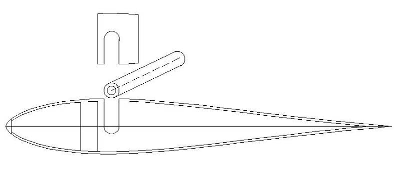

Thanks for your answer. It seems that there isn't to many people with my version of the Seagull Edge 540.
The wing incidence is the angle of atack that the wing has at the fuselage root. Since this is defined by the chord of the wing profile and the line of flight of the fuselage (datum line), the wing incidence doesn't have nothing to do with installing the servos.
You mus be talking about trimming the aircraft. For that you need the servos.

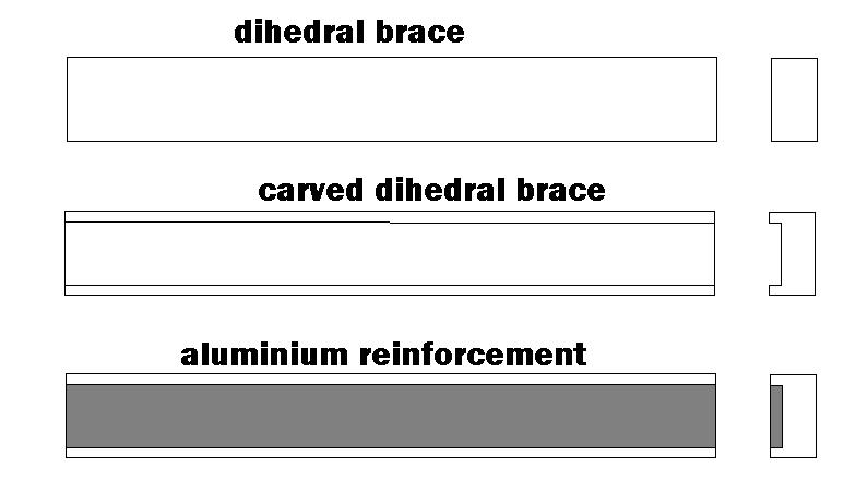

There have been some reports of people having the wing folding during flight. Not as much as the horizontal tail, but still...
So I reinforced the wood dihedral bracing with a bar of 2mm thickness aluminium. Just in case...

Since you're pulling out the cover of wing, inspect the spar for gaps, and specially for components that aren't properly glued (some people had problems with that kind of things).
I'm not sure, but I think the wings broke in flight somewhere near the second profile. I think you'll have to make an assessment regarding the condition of the construction of your wing.
In my case I just, decided to reinforce the wing as a precaution.

I'd like to hear how you reinforced the wing as I just found last night that I'll have to do the same thing.
I was thinking of inlaying a carbon fiber strip across the wing, maybe atop the spar. Also, just behind the spar box section (don't recall what this area is called, between the ribs running vertically. the little rectangle pieces that tie the spars together) Those seem to be junk.
This is why I went with the V2 first....far less work was involved to get it in the air.
