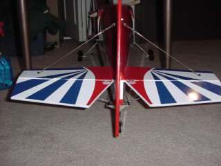

Posts: 45
From: Michigan
Default Seagull Models Edge 540
Well it's all put together and flight ready. By my calculation with my engine I need 5oz in the front to balance at 3-1/2" back. I used the lead strips and stuck them on the cowl in front is this ok?
Or should I find a more solid mount for the lead?
I bought the sullivan flying wire kit and braced it up today I also glassed the wings, and balanced it. It needed another 1/2oz in the nose with the wires. So now all I need is a the right weather, and away she goes.
Old 06-06-2003 | 01:52 AM

Posts: 45
From: Michigan
Here is a pic

From: Goderich, ON, CANADA
Looks great! Good luck
Old 06-10-2003 | 05:46 PM
