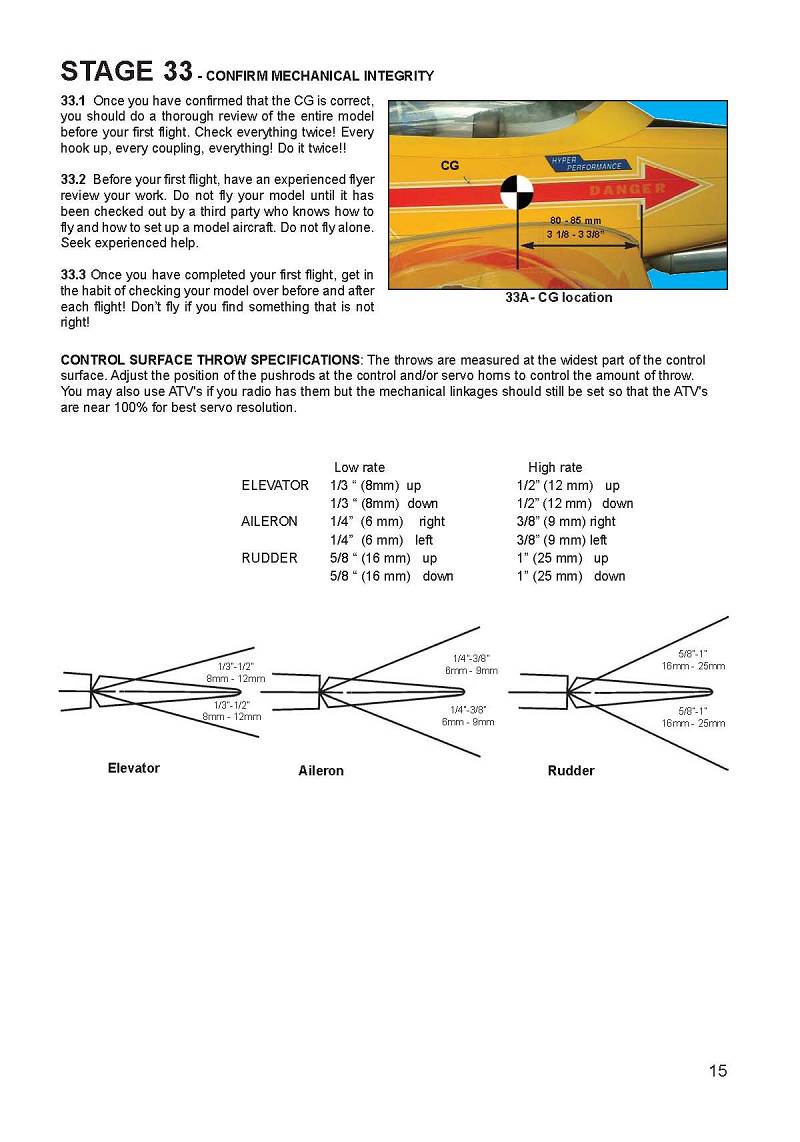

Hi
As per attachment above is the rates for the plane and the C.G for it as well,Thats what i set it up to,
They way i did the C.G for the plane was to use my pointer fingers as i don`t have a Great Planes C.G Balancer as yet
Is there another better way to do so untill i get a C.G Balancer??
The C.G on th plane beforew i added any weight was 125mm from the leading edge,
In saying that i found this site wich states a printing error in the instruction manual fro the C.G for this plane
[link]http://142.179.114.175/novo/default.asp?id=382&Lang=1&SID=[/link]
Thank`s

My Feedback: (551)
RE: ARROW TIGER 40-52 LIFT PROBLEM
ORIGINAL: krammer
Hi Jim,
I still had to add 200grams to get it to balance at the 3-3/4" mark?
Hi Jim,
Turn the airplane upside down and measure back 3 3/4" from the leading edge at both sides of the fuselage and make marks on the bottom of the wing. Transfer this point to the center of the wing by drawing a line between the marks. Now drill a hole into the wing at the center and screw in a big screw-eye. Lift the plane by the screw eye.
You can remove the screw eye after you are done and cover the hole with tape.
I think you will find that you are still way too nose-heavy.
Jim

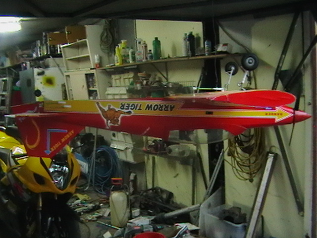

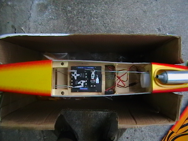

OK JIM,
I mentioned earlier The C.G on th plane before i added any weight was 125mm from the leading edge,
I did as you said as you will see in the pictures below,
I measured back from the leading edge 3 3/4" and drew the lines,inserted hook screw and hang the plane upside down,
It is level (with the 200gramms of weight in it)
I have 100 gramms of lead with the battery pack witch is on the top of the fuel tank,and the other 100 gramms lead melted and formed in the engine cowl as in pictures.
Krammer
